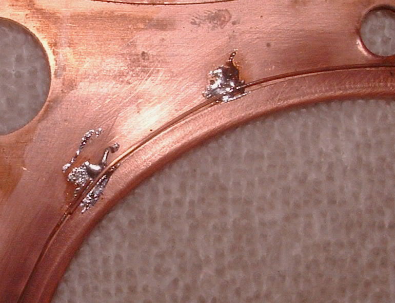

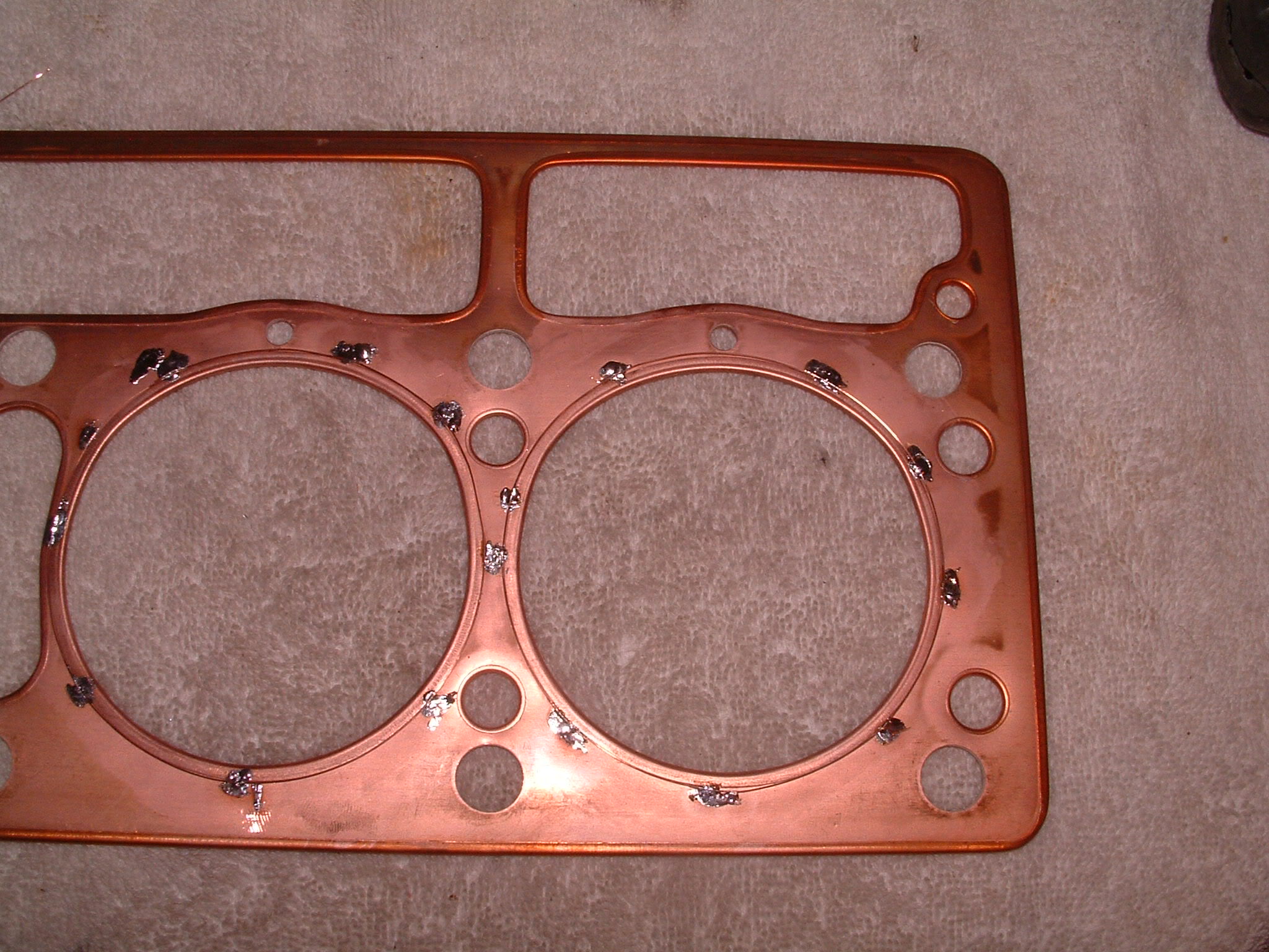

Here's something I found on the internet but have not done. Small dia. copper wire soldered to the head gasket. Comments ?
