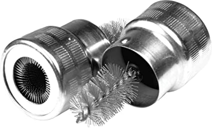

Ed - you might want to remove both cables from the battery, and wire brush the two terminal posts, as well as the inside of the cable clamps.
I use one of these:
