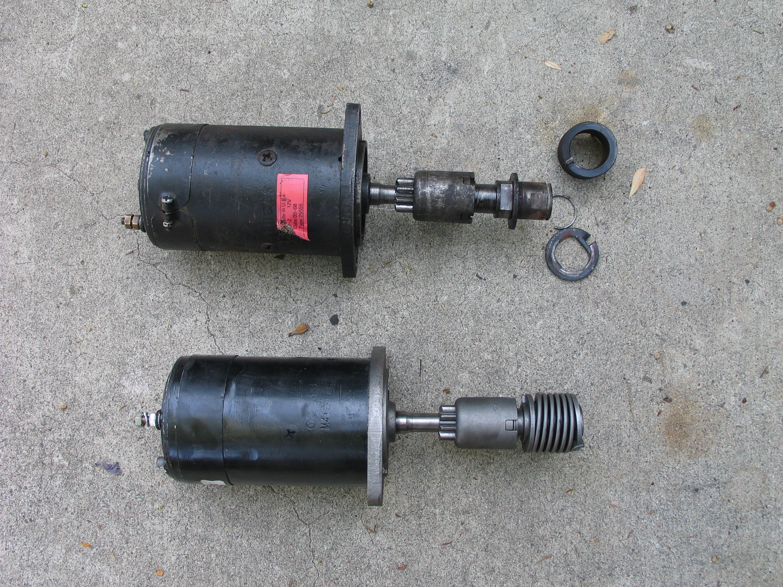

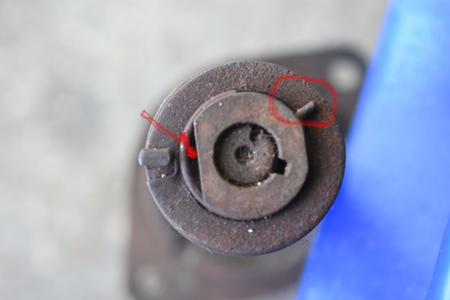

Alternately you could TRY crawling back into the "chunnel" and with the starter stuffed back in, try to remove the Bendix assembly by wedging the retaining spring with a screwdriver (at the hastily drawn arrow) and prying the curled part away from its groove. The Bendix will unload from the shaft. More "wiggle room" as you try getting it past ring gear, oil filter etc.

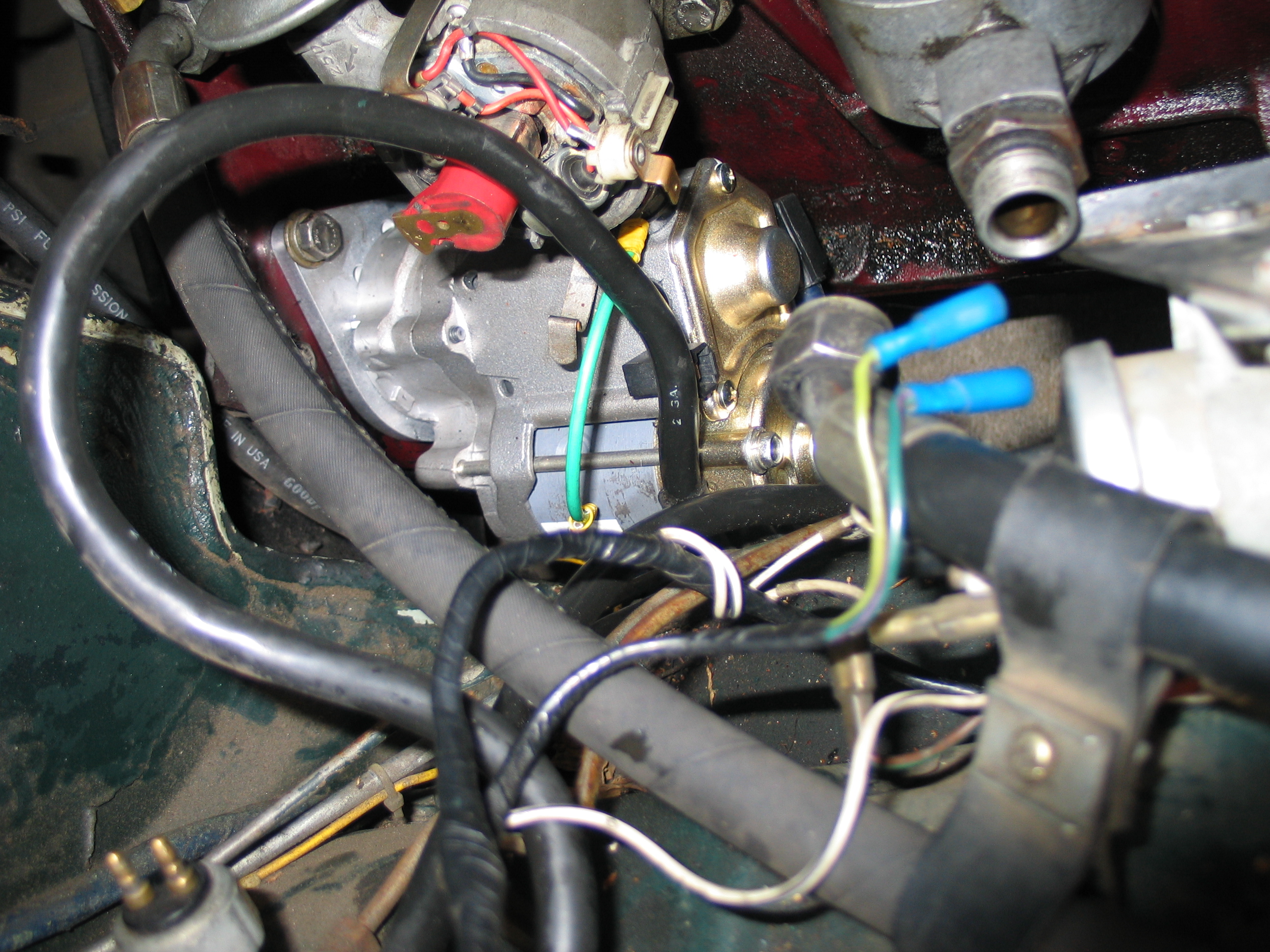

So as a follow up I decided to purchase the Gear Reduction starter from British Starters.The ring gear was a little
"chewed" and being that the new starter engages from the opposite side where the teeth are good I thought it best.Also-the initial misalignment that required me to remove the pinon and spring to extract the starter would have necessary to put it back in-very difficult in the "chunnel!".

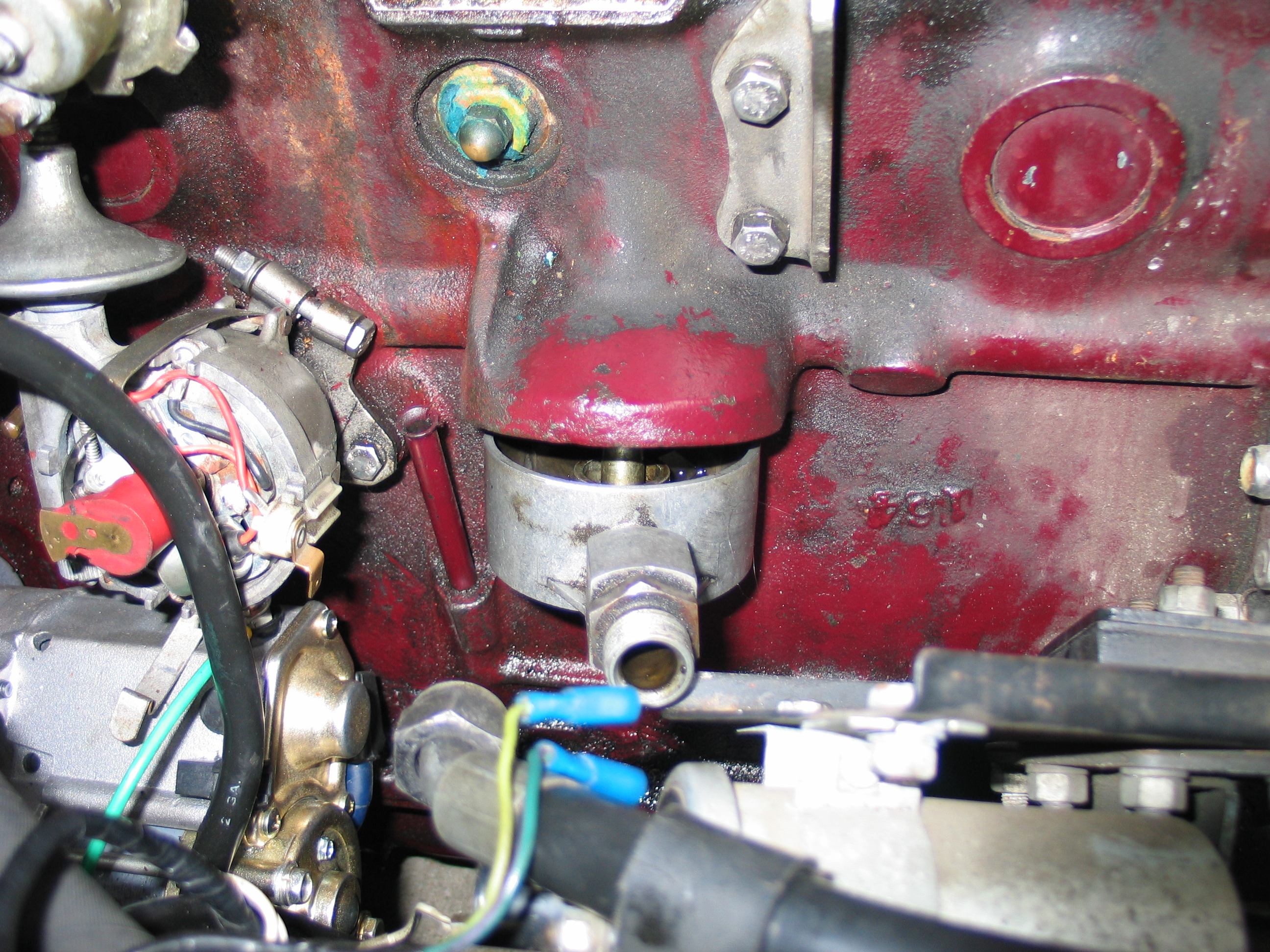

Upon removing my spin-on adaptor I noticed there was no o-ring where the adaptor meets the block-is there supposed to be one?

Regarding the new starter, we have a "WOSP" branded one on this current MGB, same issue with the ring gear prompted the change. Works fine.
As for the o-ring at the oil filter, there is a recessed groove in the protrusion of the block where the cooler line adaptor seats, a square rubber o-ring should be in that groove. Hard to see and MANY folks have made the mistake of trying to put another one in there without realizing they've "doubled up" on it and created an oil leak. I'm betting there's one in there and age-hardened to the degree it appears to be missing. The canister type filters usually have the set of o-rings included with the packaging. Most parts stores will have the old-style filter with the rings included, or can have it in a day. A Hastings brand, part number LF172 should get a cross-reference to about all makers' numbers. A "dentist's pick" or other awl-like tool is best for getting the old one out of that groove, BTW.

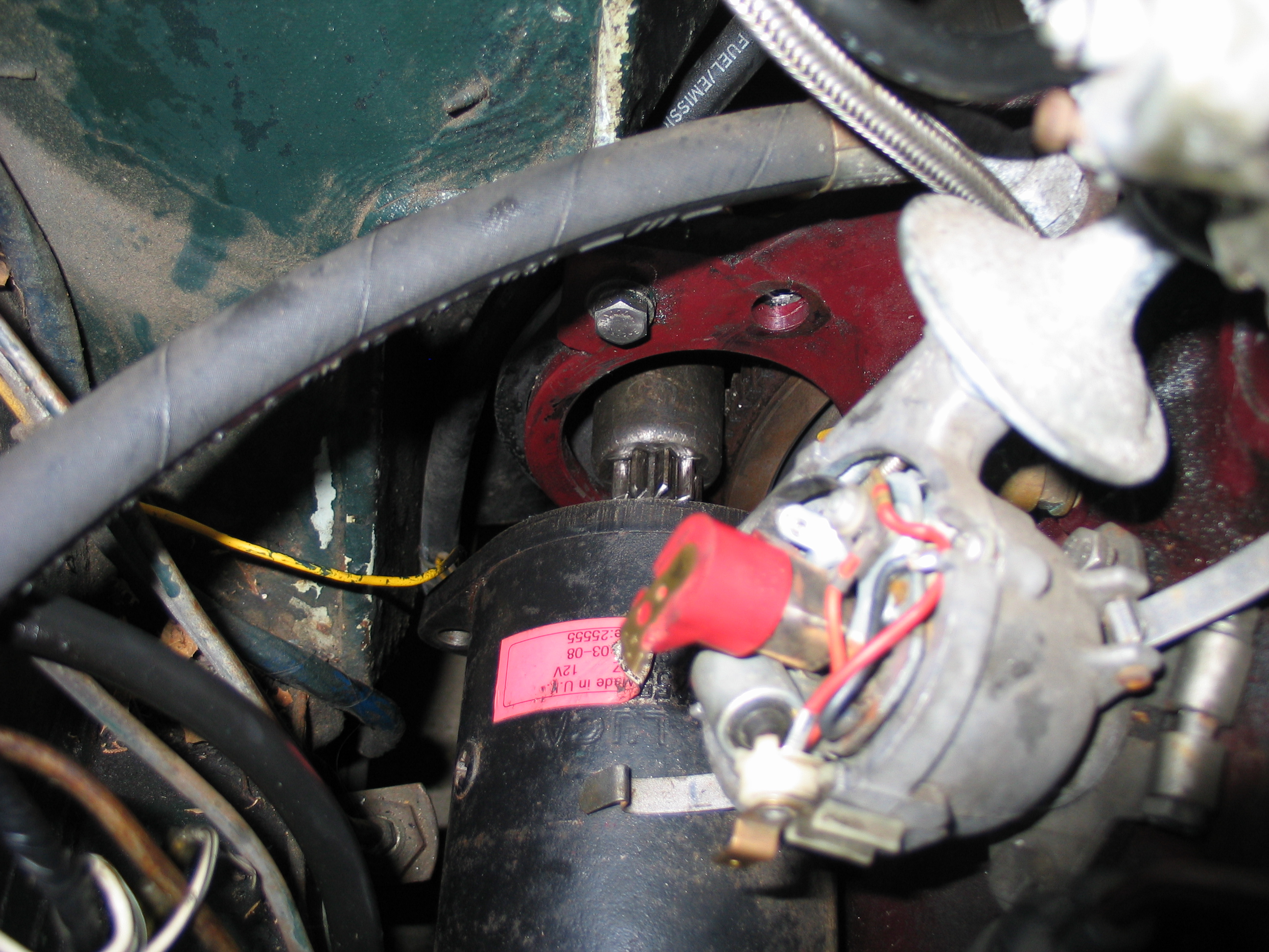

Just recalled... COVER that big connection on the starter with an insulating cap of some sort. The clips on the distributor can come in contact with it and regardless of the ignition switch being on or off, it will short out! That lead is carrying battery voltage at all times.

Thank You for that-
In fact I noticed very little clearance between the hot cable and
post top to distributor when fastened.It had been in the back if my mind...

If you use the version that has its own trigger wire and keeps the remote solenoid it isn't a big issue.
