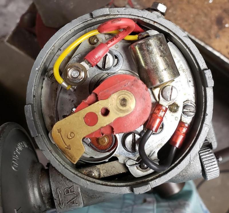

95% of all fuel problems are electrical. Likely a bad condenser, rotor or coil.
Lots of problems in the last few years with condensers and rotors. If rotor has a metal rivet they are notorious. Red rotors are best. IMO the yellow-wire condensers from the Distributor doctor in UK are most reliable.

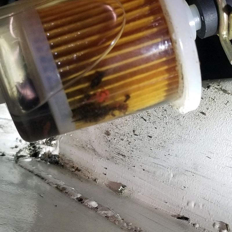

Do you have a filter between the tank and the fuel pump?
This is what my filter looked like after about 1000 miles. The tank was clean and the lines were new.
David
