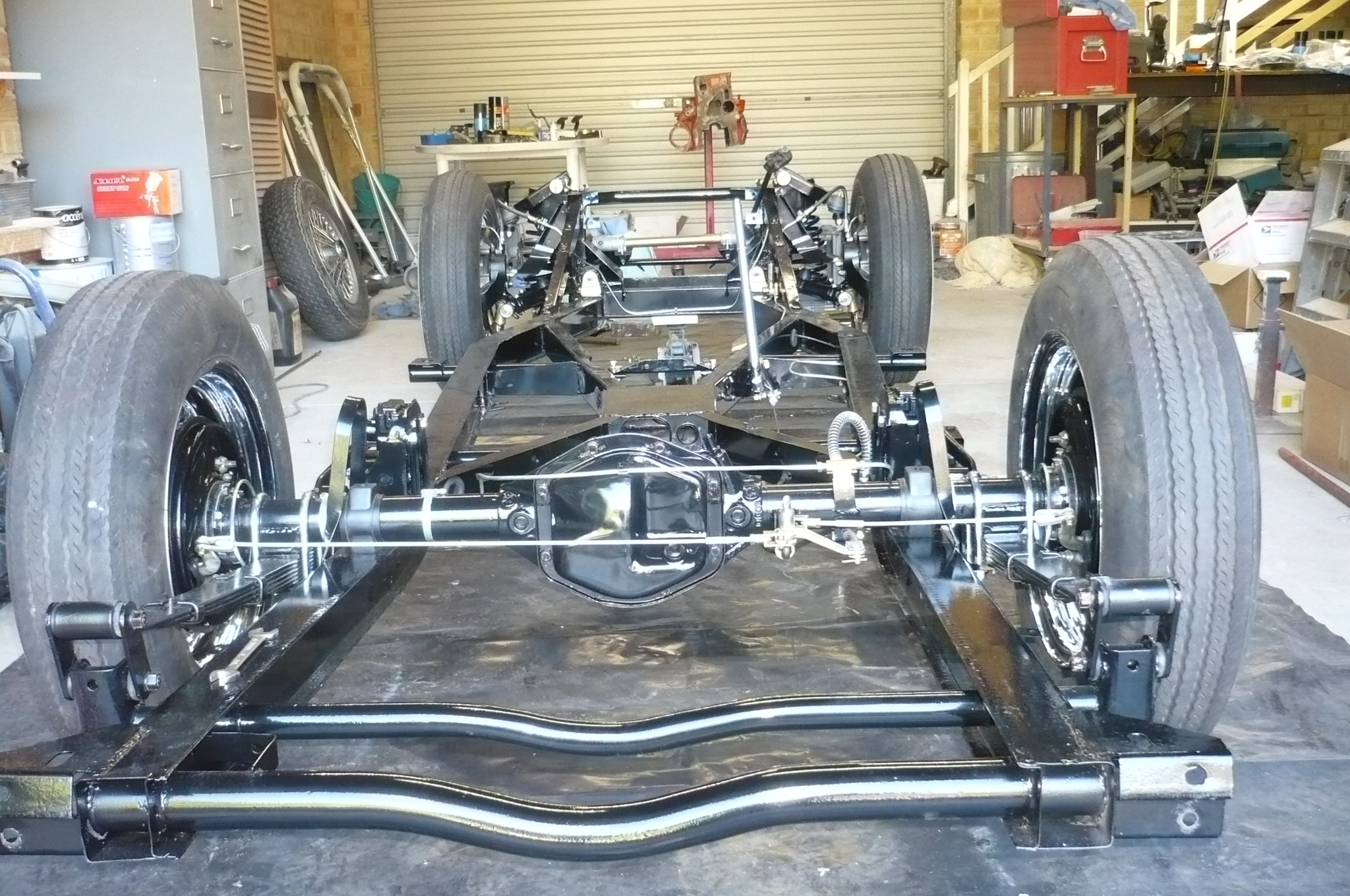

I must admit I did paint my rear springs after they were dismantled and cleaned, I do spray them with CRC if they get a bit grunty. Yours will probably be ok, just make sure they go back together the same as they are, the one with the two extra small leaves was designed to lift the driver side when you don't have a passenger and I can't remember which side it goes on.
Graham

Great looking chassis Graham. Looking forward to some day getting to get to start reassembly with fresh painted,clean parts. Seems my car just keeps on giving. I don't know much about leaf springs but with this entire project I have another opportunity to learn a little more about the car. I will do some more research, clean up what I have and then decide if the originals are ok or if I need to start saving for new ones. Frank
