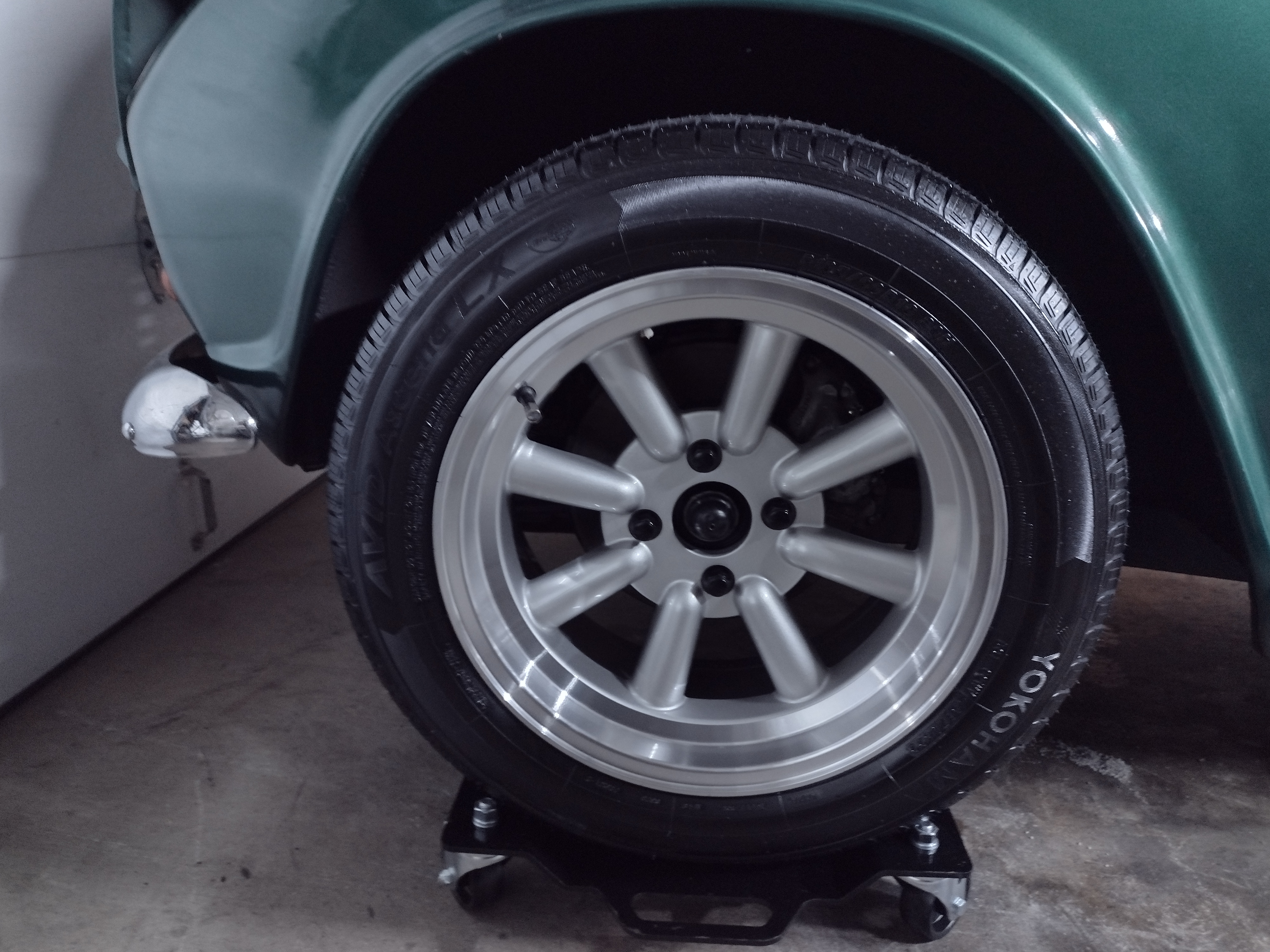

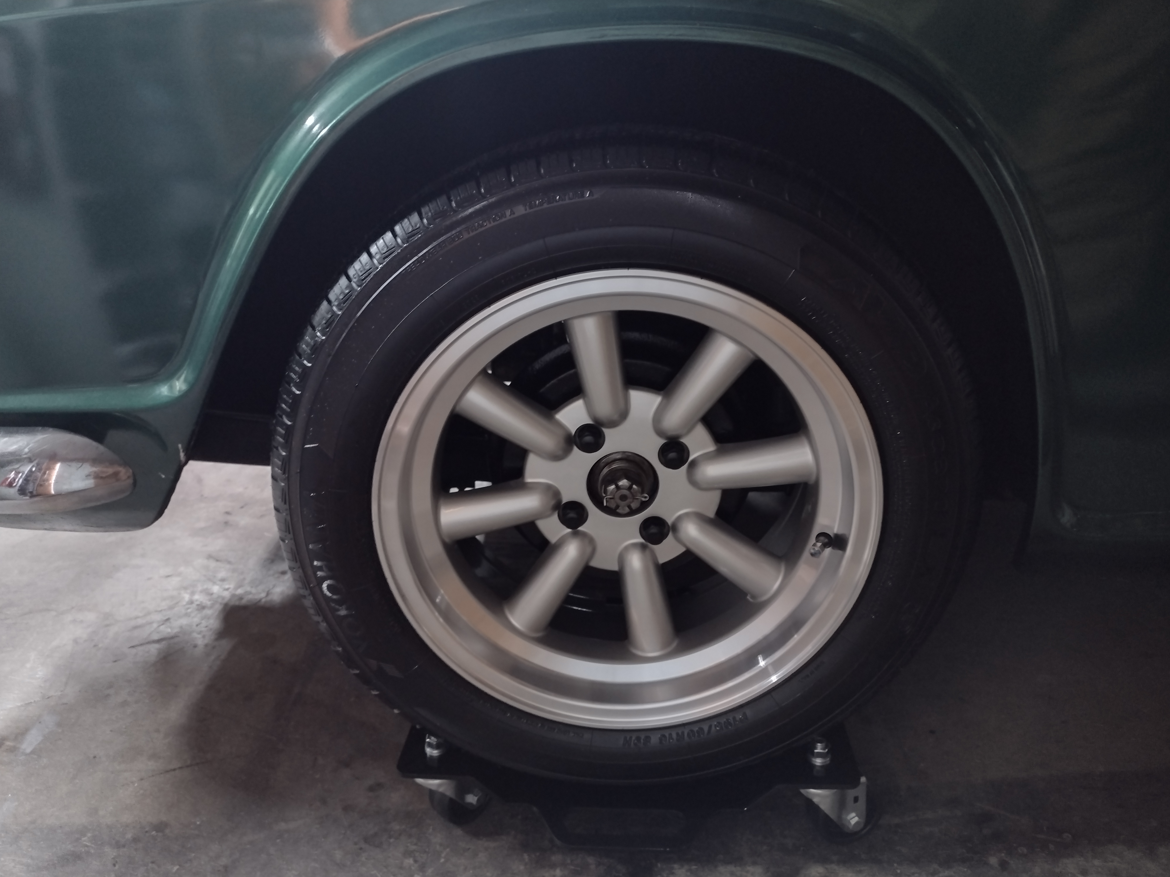

I am seeking advice or experiences from fitting Konig 16"x7" wheels to a TR-4.

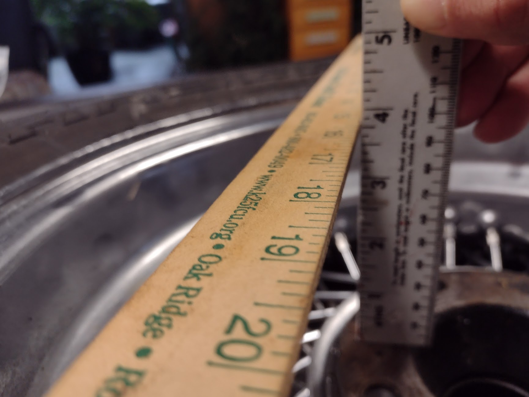

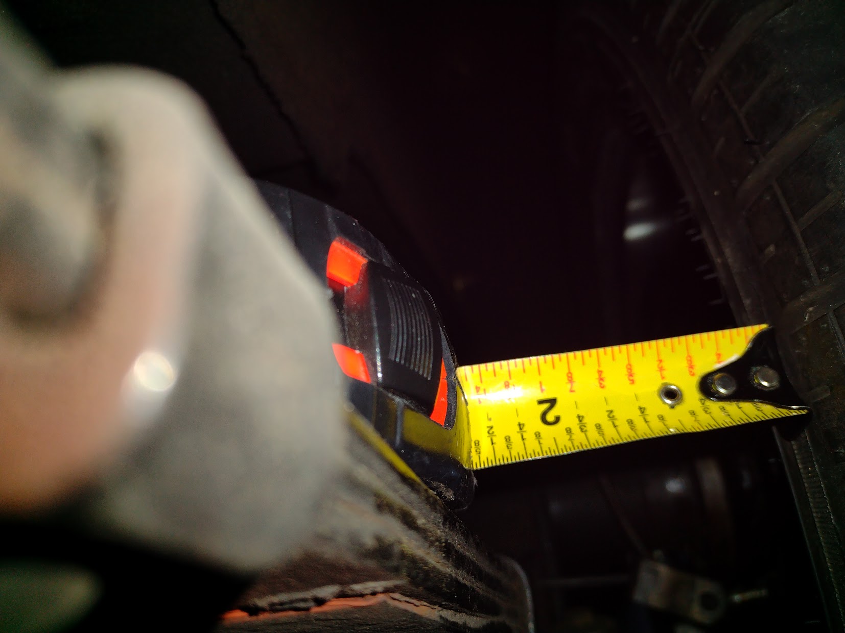

I currently run 72 spoke wire wheels with 185/65-15 tires. The wheels have a backspace of 3-5/8" with the spline hub extension in place. The current distance between tires and leaf springs is 2.5".
Wire Wheel Backspace (3.625 in).jpgKonig Wheel Backspace (4.125 in).jpgcurrent Tide-Wheel (2.5 inch gap to leaf springs).jpg

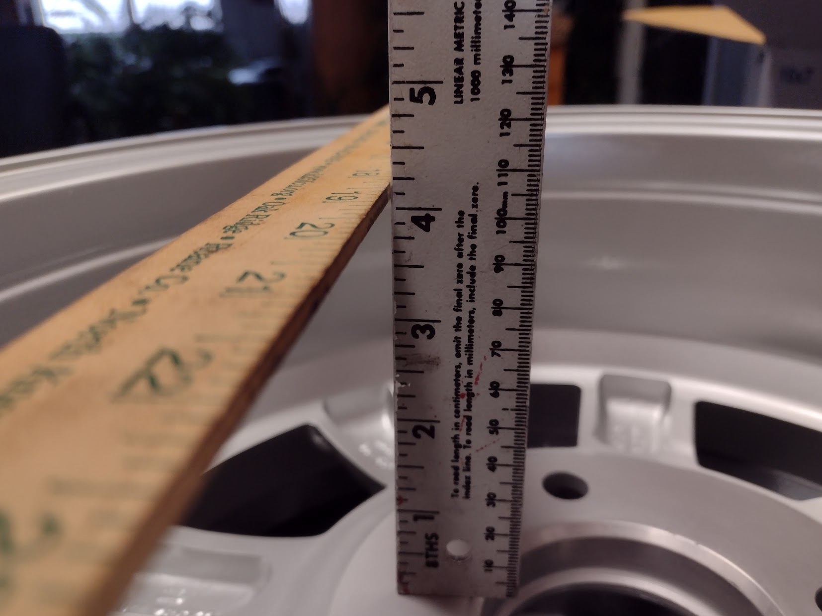

The konig wheels have a backspace of 4-1/4". The backspace change alone will narrow my tire to leaf spring gap by 1/2" (4-1/4 minus 3-5/8).
