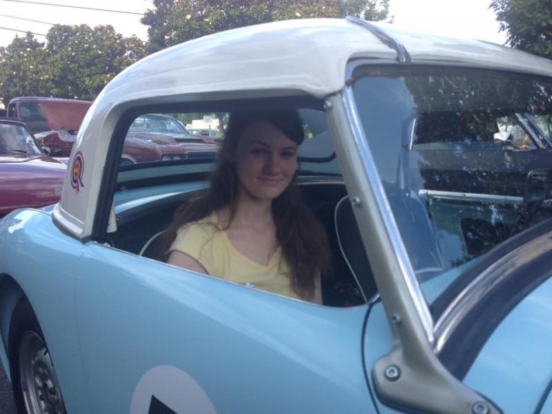

I restored my hardtop about 8 years ago and still looks great. I got my fiberglass supplies from https://www.tapplastics.com ( they are local and have videos on their web page on how to use their products). Per Doc's & Tony B's recommendation I put two layers of glass on the underside of the top to strengthen it ( this is why the cracks develop). I sanded down the entire top and and the groved out all the spider cracks with a dremal. Filled the cracks with resein sanded it all down and then applied new gel coat over the areas that were "thinned of gel coat".
Next primer with Interlux brightsides ( fiber glass boat paint) and sand. Then painted with Interlux Brightside white (very close to the original white. Wet sand and buff. I rolled on all my paint, if you do not have the abilit to shoot it on.
