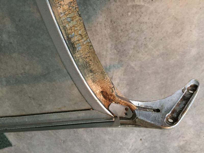

My TR3b has the latest stanchion mounted directly to the scuttle with no guide plate. The attached picture shows the "corner finisher" on my late stanchion. I have no picture reference to an earlier stanchion corner finisher.
Kerry
