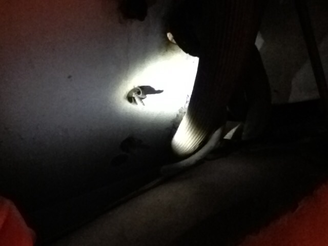

Mine has one screw in the center with a clip on the back. Sorry for the bad pic - ( on my knees, backward camera on the iPad with a small LED light. )

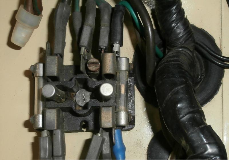

Here's mine, not much better. It's the middle one. Tom
Kleykamp
Your assumption is correct. Screw with clip, is in center of fuse block. (as per photo above) At bottom of fuse block is a upside down "U" shaped cut out where the other self tapping screw goes directly into the bulkhead. Just went out and looked at mine as I had forgotten about the smaller screw at the bottom. It seems neither picture shows the small self tapping screw, but mine, a '61 had the hole drilled and when the fuse block was removed for painting of bulkhead, it was bagged and tagged with both screws.???

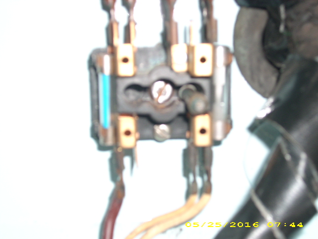

6TTR3A
My 3A (TS72099, March 1960) had the 2 holes but when I was putting everything back together I ASSUMED (you know what that means!) that a PO had drilled the extra hole & carved the u-shape in the box. I felt that one mount was enough so I just left it. That was 20+ years ago. I forgot until Randall posed the question so I removed the cover & viola!
