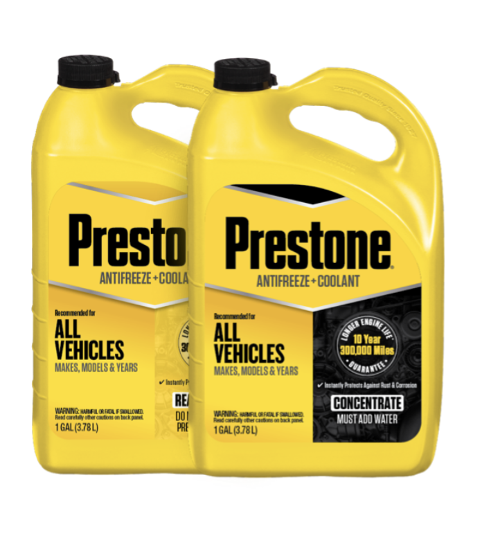

Thanks. I googled that one and it is the newer OAT formulation and is considered "yellow." Do you know how it differs from the All Vehicles 10 year Prestone below ? This is so confusing.

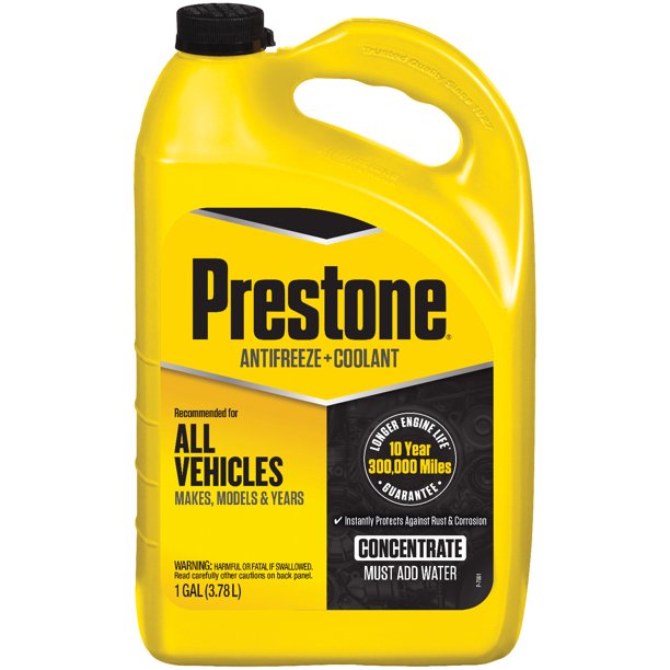

As I mentioned on the TRE thread, I just use the "regular" All Vehicle Prestone (green fluid). I didn't mean to be confusing!
