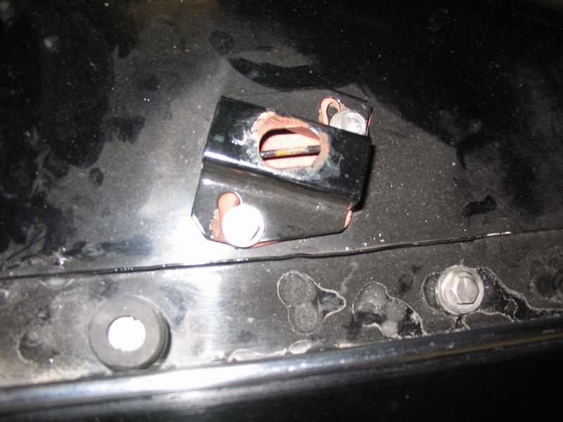

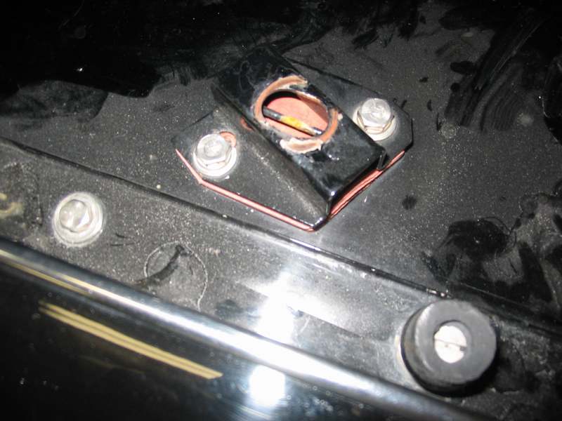

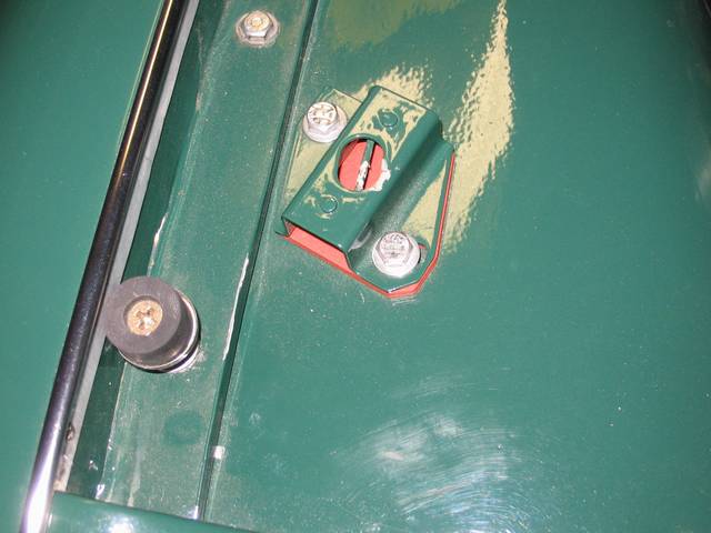

Here are photos of mine (black) and also the late TR3A (green) that I finished in June 2006.

As Don's photo shows, the buffers just replace the first inner/outer wing/fender bolts behind the edge of the apron. Not quite so clear is the additional nut & flat washer at the base, that still clamps the panels together.
One of our local club members has added a second pair of buffers near the rear, in an attempt to reduce vibration and squeaking at the rear of the hood/bonnet. Seems like a good idea to me, but of course not original. My TR3A seemed to wear out the hood hinges because the back of the hood shook up and down (California is known for it's washboard freeways); but adding a gasket under the rear of the hood seemed to help that for me.

Thanks for the pictures and description. It is clear what I am missing and where it goes in. I also understand how I did not realize it was missing as I just put a bolt in there like the rest of the ones that hold the wing in place. I have one more thing to add to my next parts order.
