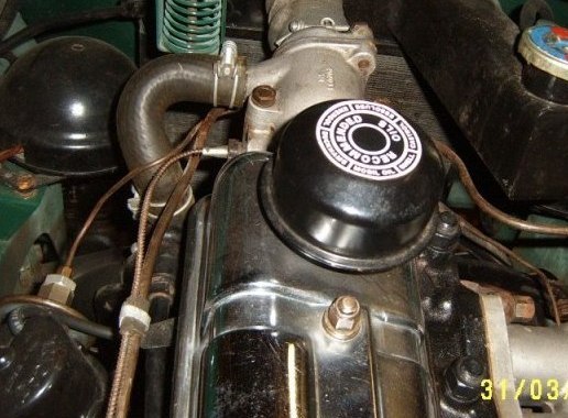

After looking at some original (I think) cars, the tape was a 'tacky' black fabric type. I used a type of electrical tape that was close. Sorry - this is the best picture I could find right now.

George, Jeff: I noticed that the oil fill cap on George's car has indentations while Jeff's pic shows one with a smooth cylinder. My 3A does not have indentations. I was not aware that there were different styles. Can you tell me which one would be correct for my 3A? TS58476LO

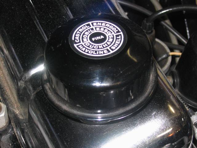

Frank - If you plan to enter your GRAY LADY in a TRA concours, put on the cap with the three indents. See a photo of mine with no indents. I lose a part of a point every year at TRA because "This is not a S-T oil cap". I argue that this is the one that came with my car when I bought it brand new in 1958, but to no avail. Greg Walker of Windsor, Ontario has been changing his cap for the 3 indent one when he goes to TRA for years. Maybe that's why he always beats me.
It seems there were three types. The two you see here plus a chromed one. I can't say why, but cars sent from Coventry to Canada and to Australia (at least) had smooth caps and cars sent to USA had the 3 indents. Maybe the factory engineers thought that Americans suffered from low torque force (limp wrists) and needed the 3 indents to help them pull them off. Who knows ?

Generally, I think the earlier cars used the smooth caps (mine's 44xxx built in Feb 59) and later ones had indentions. Like many variations, I don't know if there was an exact change point, and both were probably used for a while depending on the supplier.

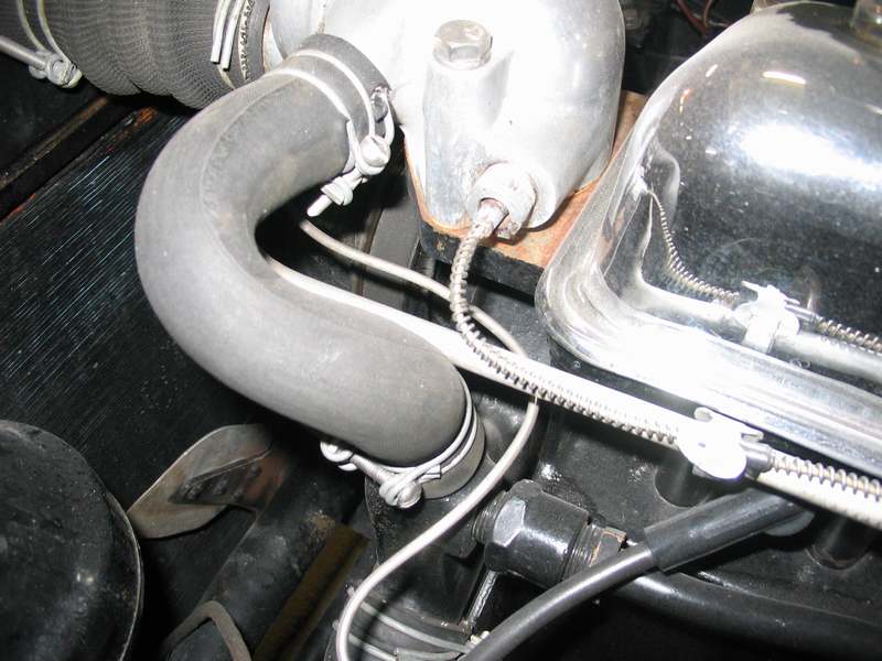

Jeff - For the top hose clamp on the by-pass hose, may I suggest that you turn the whole clamp 180 degrees so that later when you want to tighten it a half a turn, that the slot in the screw for the screwdriver is accessible from above the distributor cap, and not hidden under the valance or the bonnet spring latch assembly.

My TS23677L has the cap with the indents. I don't know if it's original, but that's what is on there.

FWIW, the cap on TS39781LO when it came to me in 1984 looked exactly like yours, Don (except for the decal and peeling paint). Obviously that doesn't prove it's original; but what are the chances of two cars almost 3000 miles apart getting the same aftermarket cap ?
Also FWIW, I don't believe that is the same "squared style" cap that the TRA guidelines say was fitted through TS17372E. It doesn't match the photo shown in the owner's manual, the diagram in the SPC, or the cap on my TS11-something TR3.

Art, here's a couple pix that might help you out, as well .....
Ah, yes. Those pics really show how the straps are installed.
