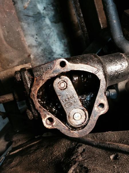

image.jpgHello,
since i am doing an apron off project, this winter, I'm wondering the best way to assess the steering box & decide if it needs a rebuild ( & how to do that too).
1: does this look like the original cover?
2: the box is filled with axle grease, is that best?
3: what's the best way to clear that stuff, to inspect the worm drive?
any help appreciated.
thx!
GP
Geo Hahn
That zerk is not original -- that would have been a fill plug and the lube used would have been gear oil.
I would be looking at whether it leaks (which may be why it got grease) and how much play it has after proper adjustment.

Geo, Thank you for your reply:
the steering has some considerable play. But it feels stiff at low speed.
No leaks though.
do you have an opinion on the Revington spring box top?

The grease is a dead give-away, it needs to be rebuilt at least. The only point in using grease is when the box is so badly worn that it won't hold oil any more. Evidently, the zerk was added because it won't even hold grease now!
The "spring top" makes no sense to me, except as a cover-up for wear and/or misadjustment. The box is designed to have some play off to the side (not straight ahead); but it mostly doesn't matter because the front suspension is always trying to pull the wheels back to straight. The only exception is at very low speeds (eg parking) where the friction of the tires on the road keeps the suspension from centering. And when properly adjusted (and not worn), the box has no play in the straight-ahead position, which is the only time it really matters.

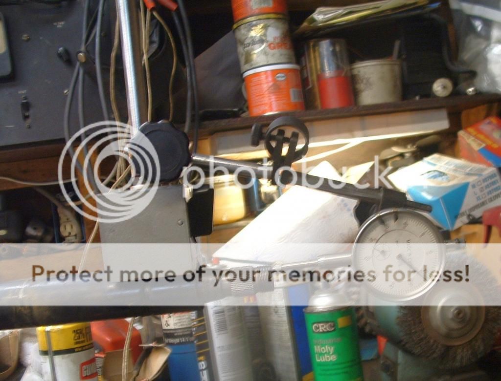

I've tried several approaches to adjustment; the one that works best for me is to hang a dial indicator on the end of the shaft (mounted to the outer column). Add a shim, then with the top adjustment backed off, observe the dial indicator while trying to move the shaft by moving the Pitman (aka drop) arm. The total indicator reading is how much shim you need to remove to get to exactly zero.
DSCF0013_crop.jpg~original
BTW, Enco almost always has an inexpensive dial indicator and magnetic base on sale for $25 or so. Definitely not the same quality as Starrett or Mitutoyo, but I've owned that one for many years now and it has served me well. Seems to be on sale for $20 at the moment. https://www.use-enco.com/CGI/INSRIT...MKANO=388&PMKBNO=3495&PMPAGE=44&PARTPG=INLMPI
Or you can get one from HF for about the same price, but in my opinion, Enco is just a little bit better even when buying the cheap "import" grade tools.
Once the end float is set to exactly zero; center the box (without hooking up the center link or steering wheel) and tighten the top adjustment just finger-tight while rocking the shaft back and forth with your fingers. The proper adjustment is when you can just barely feel the box bind as it goes through center. Lock the nut and check it again.

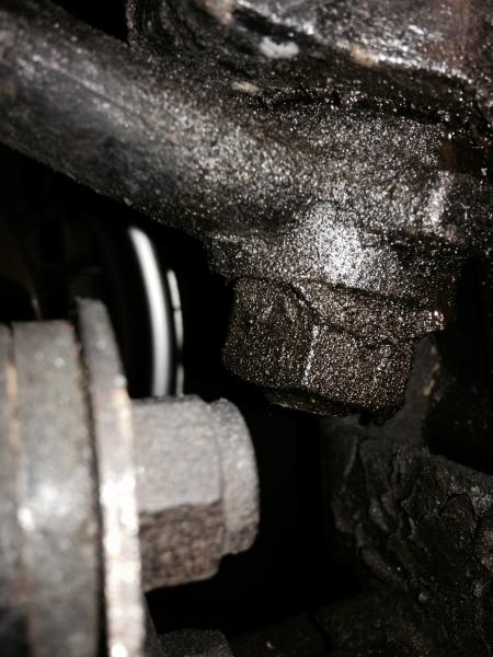

You are correct. After closer inspection, I found where grease had seeped out below the box On to the drop arm assembly.
(not much, but it was there)
