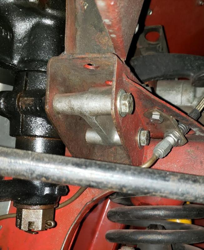

--I bolted my box with the bolt heads outward toward the fender well. This makes it possible to remove the box in the future without removing the radiator.

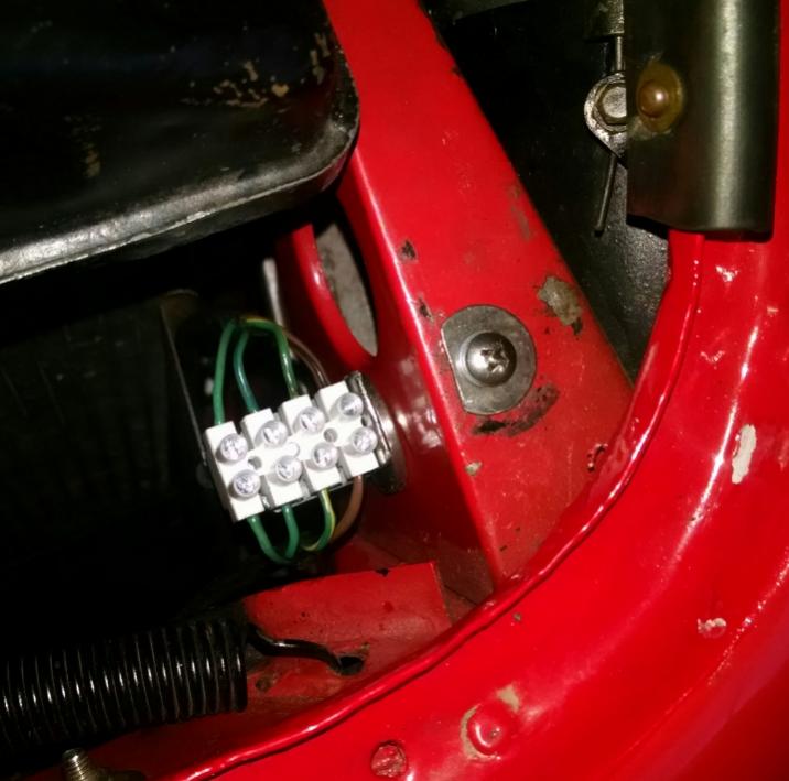

--I got tired of dealing with the trafficator wire bullets going through the stator tube. I cut the wires about a foot downstream from the bullets, tinned the ends and installed an intermediate Molex connector. Now removing the trafficator is trivial.

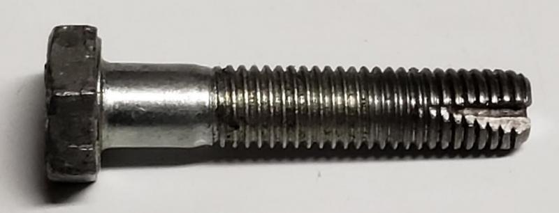

--Like to clean up the grille shroud captive nuts with a notched 1/4-28 bolt as a cleanup tap - makes it easier to run these in by hand on re-installation of grille.

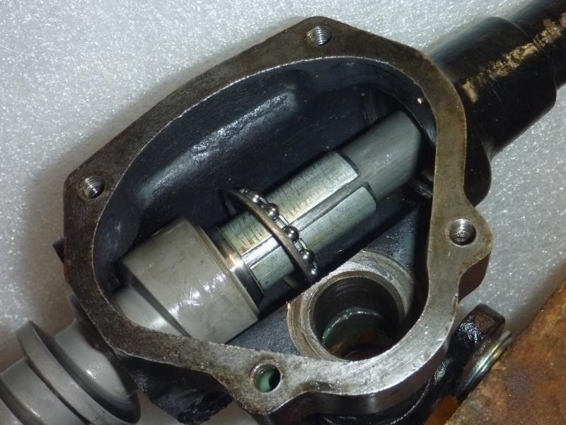

I had released the front plate too far when draining the lube. When I bolted it back up, I didn't realize the rear bearing was cocked on it's race. After a while, the cocked bearing ate the worm's integral race and I elected to replace the worm, rather than buying a new box. I'd follow the latter course if I had to do it over.
I fitted the standard-ratio worm. There's also a quick-ratio worm.
Bob_Spidell
Don't feel bad, I did the same thing on my BN2 (got away with just a new bearing, though). I think this disaster can be prevented by leaving the steering wheel on during operations on the box.
steveg
Good advice!
I fitted my DWR worm with a "centering sleeve" made from a piece of household electrical conduit. It prevents the rear bearing from seating cocked no matter how far the worm is withdrawn. The bearing doesn't touch it when seated on its race and there's enough clearance in the box bore so the sleeve doesn't touch there either.
