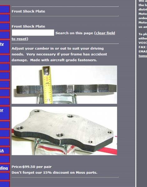

steveg
Tom's Import Toys sells a plate which replaces the captive nuts. You have to partially saw off the end of the shock mount enough to open up the area with the captive nuts; then you knock them out and insert the plate; then weld up the end.

Trotti, you can do it with a Mig. Just practice a little before you work on your car. I did this repair many years ago before I was accustom to taking pictures during my work. At the time I'm not sure that anyone supplied a fitted plate. I bought 3/8" plate and cut it to size then slid it in place and marked my bolt hole location with a self centering punch thru the existing holes in the top plate. You can actually do this with very little welding. You cut out the side wall (the side facing the tire) to the shock mount plate, use a cut off wheel or sabre saw. Then the nuts will be exposed. Knock the nuts off with a chisel, slide the new plate under the mount plate. Mark it, drill it, tap it then reinsert it. Bolt the shock in place. The existing holes in the shock mount plate will locate the shock in exactly its original position. With the shock bolted up. Just weld the outer edge of the new 3/8th plate. Then replace the piece you cut out or a newly fabbed one then weld it back in place. Easy Peasey.

steveg - thanks for the tip and also thanks for the photos you have on your website.

I forgot to mention on the front shock plates from Tom's: I was not able to get all the captive nuts loose by hitting with a big punch from the side. What really worked for me was to run a short bolt into the nut enough to have all the threads engaged and have the head of the bolt up at least 1/4" from the surface, then hit the bolt straight down with your lead hammer - that got them loose pretty easily.
Addendum: if the threads are stripped, tap the captive nut for metric M10 size and use a 10mm bolt.

Am I correct in thinking that if you want to adjust camber with these plates that you have to elongate the existing holes (in addition to knocking the captive nuts out)? Also, presumably, you can adjust caster by enlarging the holes front and back (but not excessively)? Also too, you could inadvertently change caster if you didn't elongate left/right correctly? But, if you make the holes too big the 'ears' on the shocks might not have enough surface to ride on?
I guess, if you only want to tweak camber, you would scribe a straight line between the centers of the existing holes and elongate along the scribe line?
steveg
Yes, you'd have to elongate the holes to get more camber than you would installing an offset upper trunnion kit.
I was only looking to replace the captive nuts and not looking for more camber.
Your idea of scribing sounds like a good one for adding camber or making sure you get the shock back in the exact same place. In any case, measure carefully.
