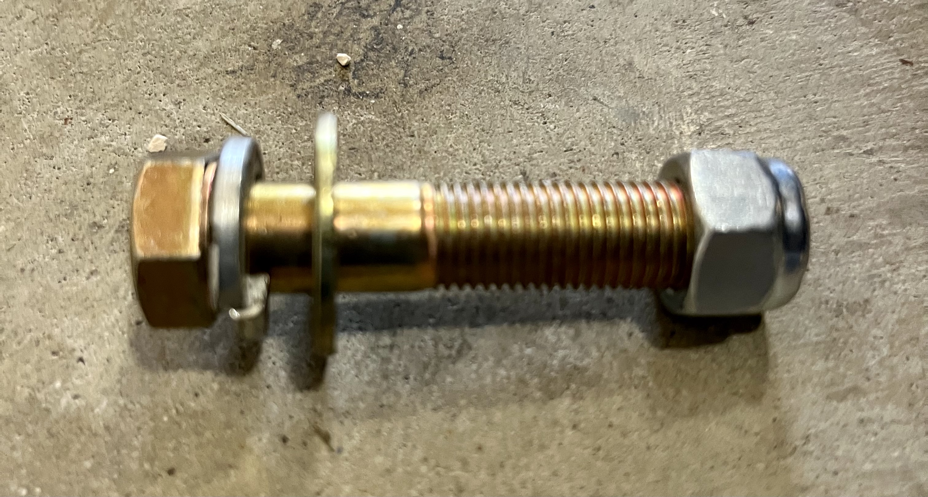

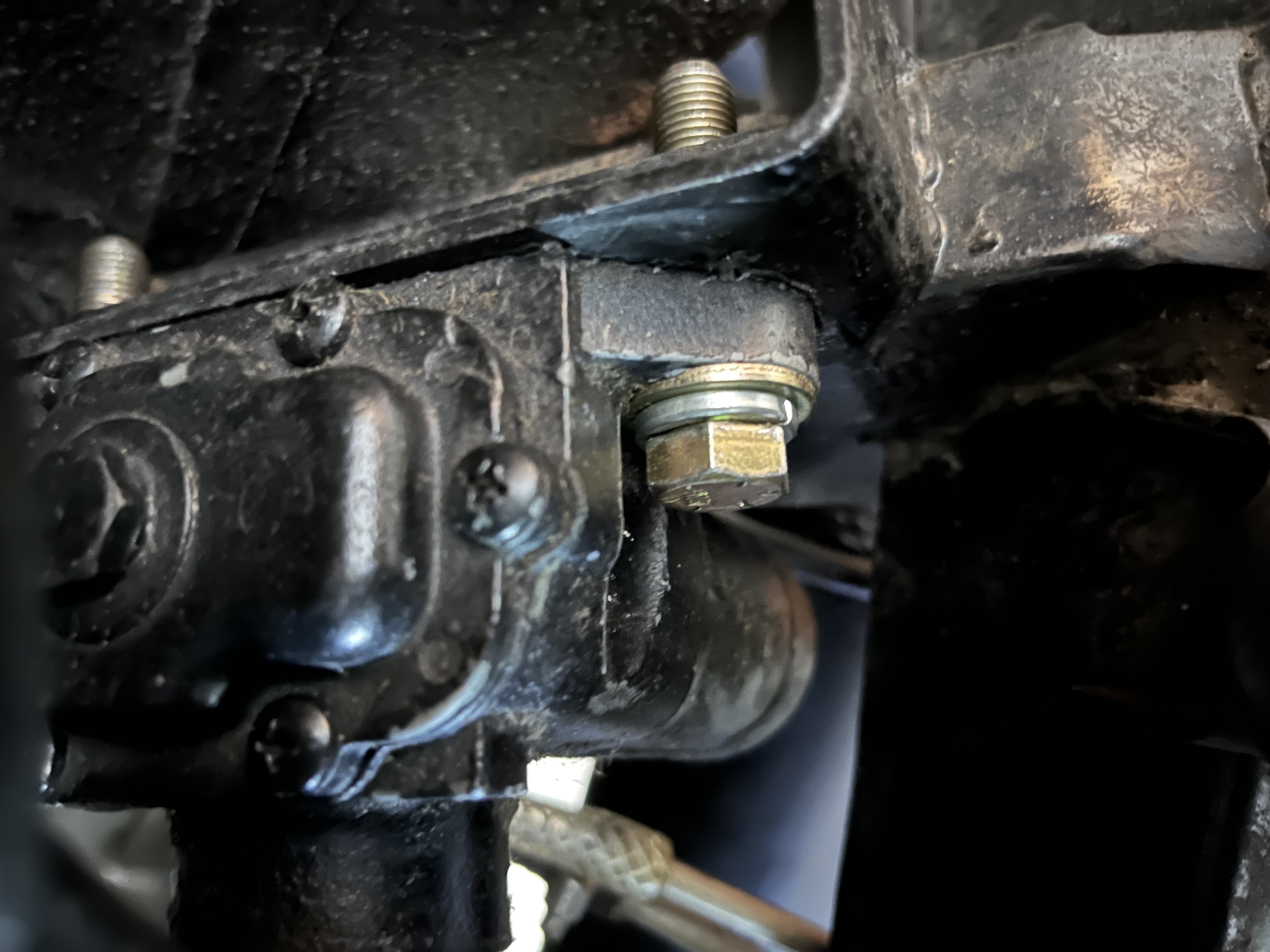

Update….
I used new bolts with a lock washer/washer on the shock side and a nyloc on the frame side, then tighten the snot out of it ;)
Second pic showing shock install before I installed the nyloc.
Hopefully will get it off jack stands tomorrow and road test.

Update…..
After replacing the hardware and torquing the bolts the clunking noise has disappeared!

Fitting a flat washer under a spring/lock washer will not work, the flat washer can turn seperately from the shock, it can work loose again,
its beter to fit just the sring washer.
Gliderman8
Gliderman8
Thanks for the info. I did consider that.
Not shown in the install pic is the nyloc nuts that I have installed after the threads exit the frame. In order for the bolt to loosen the nyloc nut would also have to loosen which is a remote possibility.
