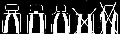

Another consideration is the seat. Attached is a picture from https://www.soloracer.com/harnschrothfaq.html , and the following excerpt:
“Seat-back/head rest construction is the most critical factor in the seat construction. The head rest must be constructed to both allow the belts to pass through and to help keep the belts from going side to side. A fully integrated headrest is not acceptable. The problem with the fully integrated headrest (far right), is that the belts can slide down the sides of the seat, and usually results in the driver sliding out of the shoulder straps under impact. A seat with no headrest, as pictured 2nd from the right, has no means of retaining the shoulder straps in the case of any sideways movement, and is also unacceptable.“
If you have factory seats without a head rest there may be an issue. You need to make your own determination on safety for obvious reasons. I’m sure a few of the race folks will give their input as well.
