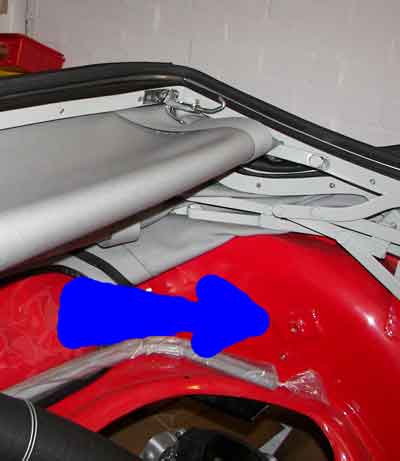

How its done on a British BJ8:
Hope this helps.

Keoke
Yep except that is a very late model car. The earlier cars will have a pair of studs in that same location that require a special anchor bit to install the shoulder strap.--Fwiw---Keoke
shorn
I used just one of the pair of studs to install the third point on my ph 1 BJ8. I thought it looked better than the adapter.

Well, I guess you just cheated the man Shorn. /bcforum/images/%%GRAEMLIN_URL%%/grin.gif The proper fitting is available from British Car Specialties and works best if you use the tonneau cover--Keoke
I probably should have emphasized that the security of the shoulder belt is significantly enhanced when both studs are used at the anchor point.
You may wish to consider the Moss detachable 3 point reatraint if you use a tonneau cover. One part of the belt over the shouder goes through the flap/hole in the tonneau.
