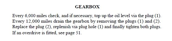

Perhaps not, but some of us think following the factory recommended service intervals might be a good idea ...

Randall: I check the oil level whenever it is convenient (about every 4000 miles), but I have the 12,000 mile figure in mind for draining and replenishing the oil. I just didn't know if there were some other schedule when an overdrive is present. Page 51 is not too helpful in this regard.
Yeah, it could be a bit more explicit. But I took it to mean that the schedule with OD was the same as without OD.
