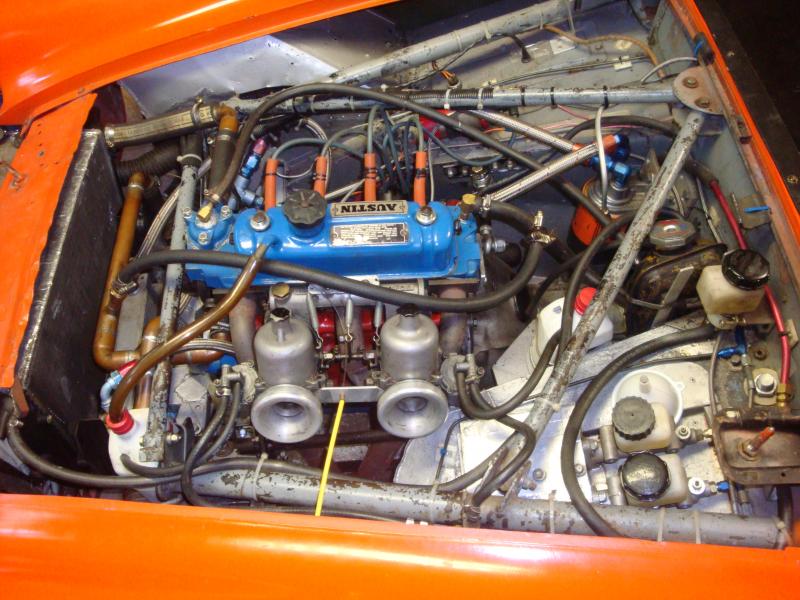

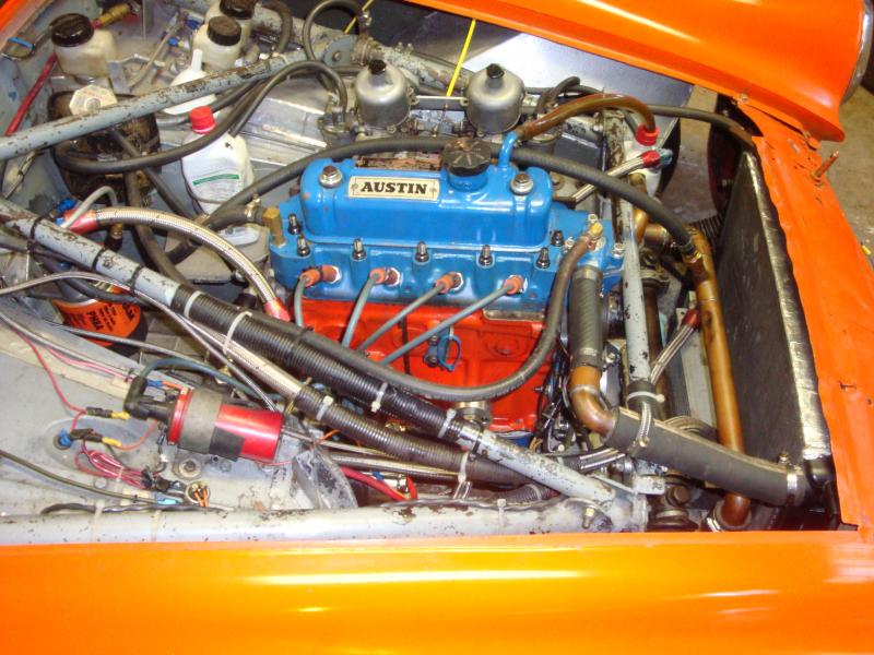

The Scrirocco radiator fit pretty easily in a non BE. You do need the cross flow piping as the inlet/outlet are the same as on the crossflow setup on the passenger side. You need to figure out hoses as the inlet outlet are larger than the stock rad.
It is directly mounted on the front cross frame on rubber mounts.
I am attaching the only pic I have of that area. Everything is rather crammed due the front end reinforcing that is tied back to the cage and this I not a concours car

Thanks Joe. Looks a bit crowded but doable. Only problem I would see is getting air flow through the sides of the radiator. It looks as if all that sheet metal behind the grill has likely been removed.

As the engine would come out 3-4 times a season everything infront except the required sheet metal was removed or removable. the top cross piece is only screwed I as opposed to being welded, it actually holds the Rad in place. The radiator shrouding was remade to fit the Scirocco rad and was attached to the cross piece.
Engine out in less than an hour. In just slightly longer. The Scirocco rad was less than $100 and kept the engine,112HP at the wheels@7500 at about 190 degrees in August.
This is overkill for street car engine.
As I said, I run my street 1275 at the same temp with a 50 YO down flow rad.
