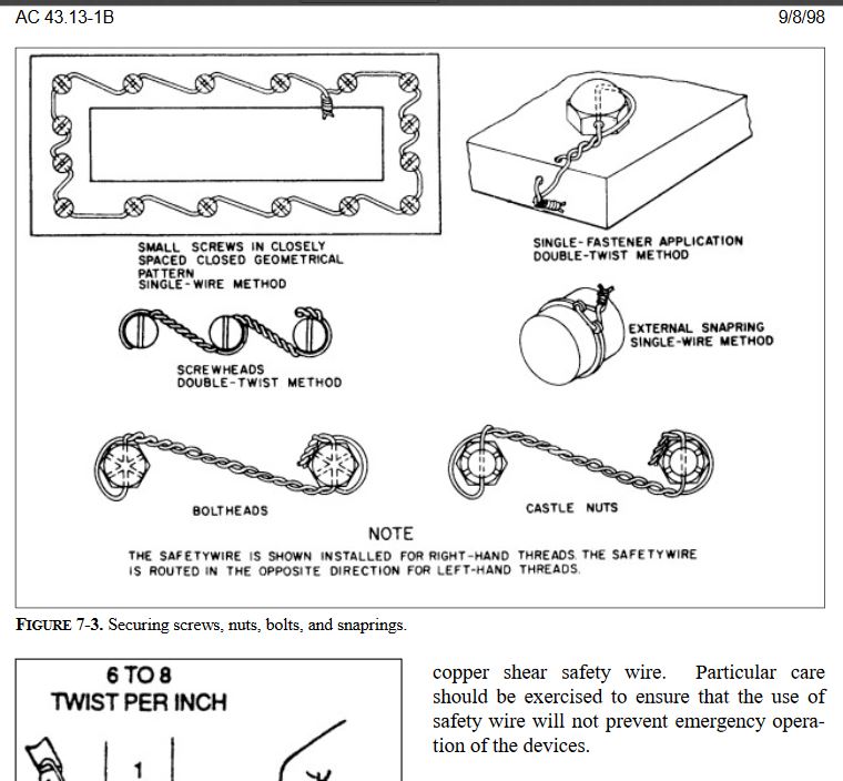

It would be possible, working from memory, to drill the bolts and nuts so that safety wiring could be used. The principle is the same: wire the nuts/bolts in such a way they resist loosening:
