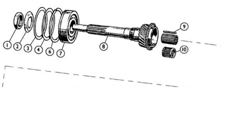

I disconnected the clutch housing from the center-gearbox and found that there was no spring washer and washer between the input shaft bearing and the housing as described in the service manual (position 3 and 4 in the Moss diagram).
Now I have seen that these two parts are not available at AH Spares and Moss. Instead, AH Spares offers shims of varying thickness. But how do you determine which shims you need to fix the ball bearing between the two housing parts?

Gerd, I don't have any experience with the Healey trans, but with some experience with an MGA trans I remember that the object was to shim so that there was no end float in the shaft. But not really tight.

From the parts book both the items ( 3 and 4 in your diagram) are actually shims 22b132 and 22b133 .
