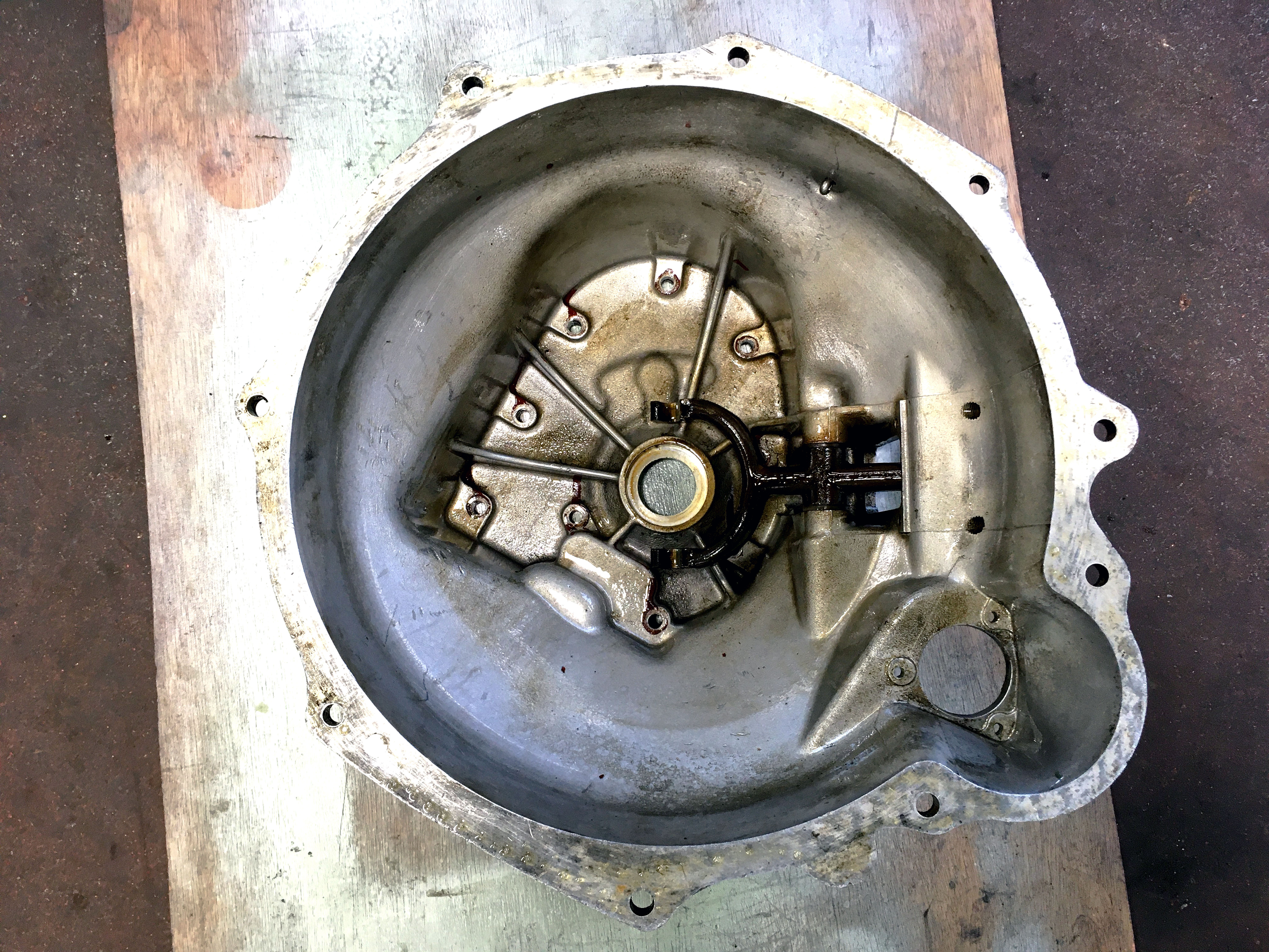

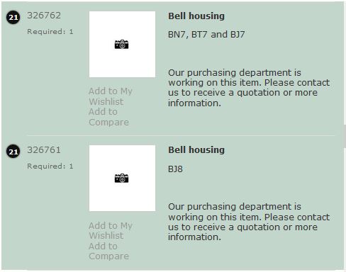

Hi,
Are all of the BJ7 and BJ8 center-shift bellhousings interchangeable (the same casting/part)?
I need a new bellhousing for a second BJ8 center-shift gearbox and wanted to make sure that all of the center-shift gearbox cars used the same bellhousing. I have searched, but can not find any information on differences between center-shift bellhousings in the various cars/years that used them.
However, the Moss catalog (and other catalogs) lists BJ7 and BJ8 center-shift bellhousing separately (although both are listed as NA). Not sure why they would do this if it is the same part?
Any help is greatly appreciated.
Thank you.
Regards, Bill

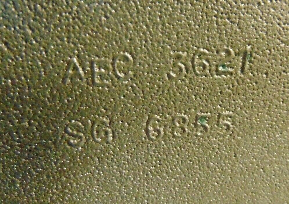

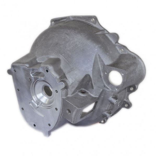

Hi again,
Looking through eBay, it seems like the BT7 and BJ8 center-shift bell-housings are the same. However, it would be great if someone knowledgeable could confirm which bell-housings work with the BJ8.
"Center-Shift Bell-housing: This is an Austin Healey 3000 transmission bell-housing BT7 and BJ8 bell-housing: part number AEC3621 SG6855."
Thanks for any help.
Regards, Bill
