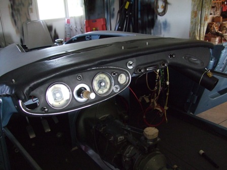

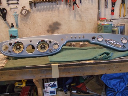

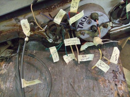

Although mine is a BJ7 These pics might give you some ideas. One shows the back of my dash before I restored it. To the right of the choke you can see the hole which had no screw in it and the dash was covered with black vinyl. Another pic shows the front of the dash and the hole is covered with the vinyl. Yet there is a bracket that lines up with the hole. after I restored the dash I decided to fasten the bracket via the hole and used a cap screw that I covered with a black cap. It looks like another black knob. I found the whole situation kind of odd because the hole is too big for one of the smaller stainless or chrome phillips head screws. I hope the pics come thru.

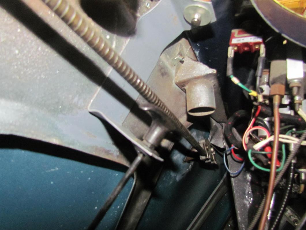

On my RHD there is a long bracket that comes off the firewall in the center that connects to the bottom center of the dash. I can grab a shot or two of it if you like? It is the choke cable mount as mentioned in the earlier post. You can see it in this photo
