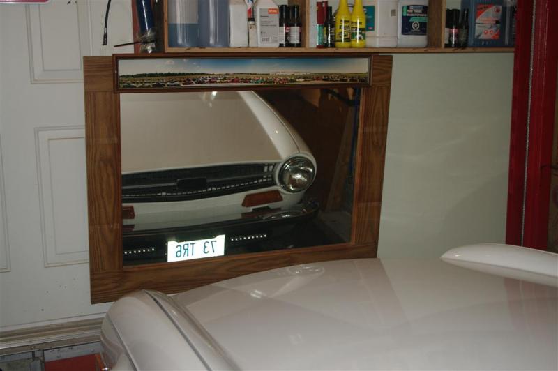

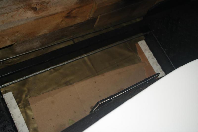

Mine is not BendPak, but is 37.5 inches between ramps. The TR6 fits no problem at all, but the TR3 only has about half inch either side for clearance. I had an old mirror around the house and mounted it at an angle in front of the lift. I also painted the edges of the ramps white to make them easier to see. Now driving onto the lift even with the TR3 is an easy one person job. I can move the TR6 and take a "driving on" picture if it helps. Cheers, Mike
