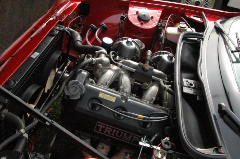

Mickey Richaud
A slant 4 engine, that's interesting. Only slant engines I knew of were the Chrysler 6s. PJ
Don't forget the TR7's!
PAUL161
Never saw a TR7 engine Mickey. Didn't know they were on a slant. A friend had a TR6, but I was not much into Triumphs, only their motor cycles. PJ
