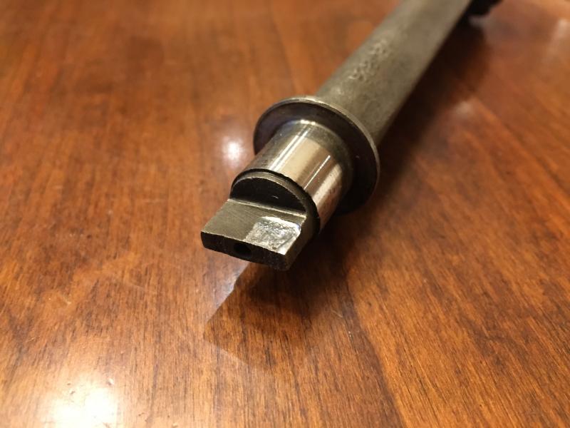

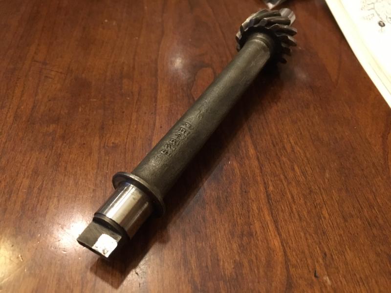

3) How do I know if I can re-use my old early BN4 oil pump? It's the rotor and vane style. Is there a easy way to diagnose a potential problem? I also have a later gear style pump that also seems to fit. It's in nice shape and came in a box of misc parts I bought. Is that a better design? I only have one driving spindle and that's from the original pump and it has some wear on the end. I'd love some advice here.

That's a lot of wear on the shaft. I just rebuilt a BJ8 engine with over 100K miles on it and the shaft looked perfect (IIRC). I think you should tear down the pump; I suspect you'll find scoring on the housing and rotor/vane and, IMO, have a machinist repair the shaft or replace the shaft. I can't tell from your photos if the gears on the shaft are worn; if so, the shaft is toast. If my shaft is in as good a shape as I think it is I'll cut you a fair deal on it--send a private message if interested--Moss wants $239.99(!), and it's only for cars from #38263 on (you also need a thrust washer--mine seems to have disappeared).
The rotor/vane type pump is more efficient at low RPMs, but were known to cause excessive wear, failures even, on the shaft and/or cam gears. The gear-type are rebuildable--British Parts Northwest, for one, has kits--but they provide a bit less pressure at low RPMs. Denis Welch recommends their 'high capacity' pump--which I believe is the rotor type--for engines that don't see 6,000RPM, and the gear type for the racers.

I do see some wear on the gears. It's not a lot but there are definitely shiny areas on the lower edges.

I agree with Bob, that is a lot of wear on the shaft & I wouldn't be very comfortable using it in a fresh engine. My personal preference is the gear type pump.
Maybe 15 years ago or so there was a lot of discussion amongst racers about the rotary vs gear pumps because the rotary pumps running at high revs (above 6k) were experiencing gear drive failures - also causing premature wear on the cam thrust plate, and DW started offering a needle roller cam thrust plate to compensate for the fast wear. One friend of mine lost the gears on a brand new DW racing cam - I don't think he had more than 4-5 hours racing when it stripped the drive gear teeth off the cam at speed and, of course, bearings and other stuff suffered as well as leaving him with a virtually new and useless 'dry sump' cam.... One racer in the midwest set up a test with the two pumps driven by an electric motor and measured the amperage draw at various rpms and found the rotary required quite a bit more power to spin that the gear type. (I believe this is why they now recommend rotary pumps for street driven cars because they will not likely see 6k or more and gear type for racing at high revs.) Anyway, my takeaway from several folks is that at least part of the issue is that the rotary pumps have (I think) 5 vanes - so for every revolution there are 5 pressure pulses. And the gear type (again, if I remember correctly) have 7 teeth - so for every revolution 7 pressure pulses. Each 'pulse' in effect is a quick load/unload on the gears and blade. So, if a given flow of output, the 'load', for want of a better descriptive, is spread over 7 pulses rather than 5, meaning each 'pulse' is milder putting less shock load on the gears. Add to that the outer ring of the rotary is heavier than the gears, requiring more power to overcome inertia. Don't misunderstand, in a street driven car the rotary are fine, however I think the extreme wear on the blade on your shaft is quite possibly due to these larger loading forces from the rotary pump. Also, the fact that there is better parts/support for the gear type, make me go that way. I have always run mine to 6k and had plenty of oil pressure from the gear type.

I tore apart both oil pumps today. Both were in excellent shape showing almost no wear. Honestly I would have no hesitation using either of them. I did buy a new driving spindle. Thanks for the advice on that one. Shockingly I even found my original thrust washer inside the "mystery bin of rusted bits" that came with my car and was able to clean it up. The oil pumps are exactly the same size and are clearly interchangable. The driving spindle is compatible with both as well. I haven't decided which one to use honestly. I'm probably leaning towards the newer gear design but it's a toss-up. I will probably toss the other on ebay.
