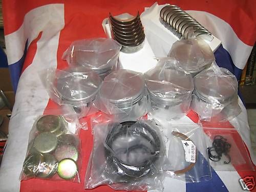

Found an engine rebuild kit on ebay that has tri-metal County bearings, and includes all parts with pistons and rings for $479. Sounds like a good deal. Anyone have any experience with County bearings?

If I were a Brit I would take serious offense at the seller's use of the flag as a tablecloth.

Agreed. I'm not a native Brit but I don't think it appropriate for the Union Jack.
