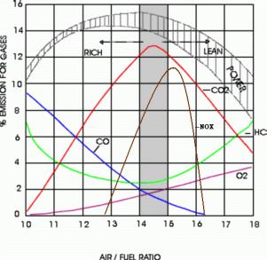

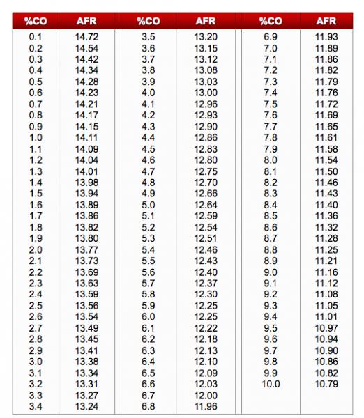

Hope this helps. Rear richer than front, but i would guess both are too rich. CO should be more like 2% or less.
