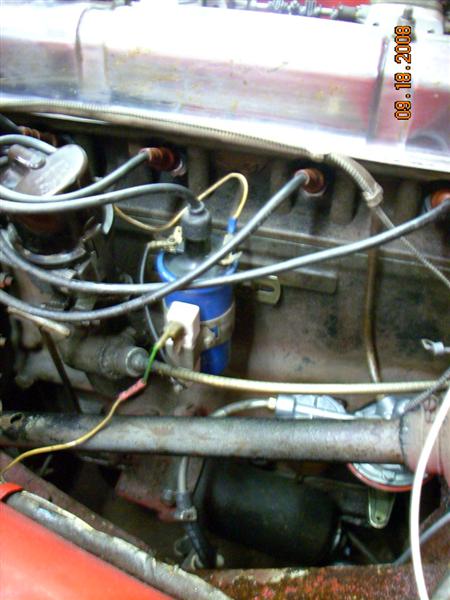

R
Royal_58

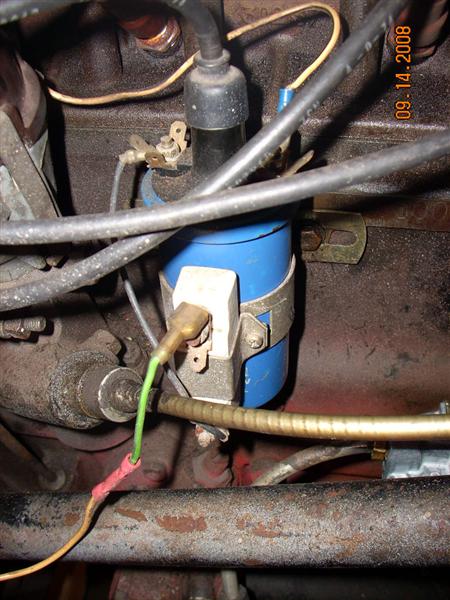

This one a a bit out of focus...the "love" bugs are out in the Deep South.
Well. this Ol' fashoned rogering was interupted abruptly by a reserected TR3 !!!!
TR3driver
Great Pumpkin - R.I.P
Yup, that's an aftermarket "universal" coil; which probably came with the resistor just for applications like this one that did not originally have one.
Should work fine, but I'd double-check that the polarity markings on the coil match your battery polarity. The car was originally positive ground, but it's very common to convert to negative ground. Also try tugging on the crimp connections, to make sure they are secure. I've seen enough crimps go intermittant with time, heat and vibration that I refuse to use them on my cars.
And those definitely look like carbon-core wires (again universal replacements).
BTW, there is supposed to be a rubber plug in that hole in the steering column (which is for filling the steering box with gear oil).
Also BTW, that dizzy cap is from a MG or something, but should work OK.
