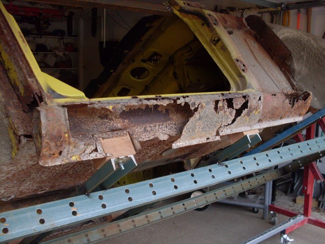

It has been a roller coaster week.. I though I was buying a father-son project with a suspension problem... But it was actually a frame issue..
I have to step back and assess... I am going to get it to a restorer who actually does this type fab work and then decide depending on if he will fix the frame, and how much it will cost...
But the community knows more about these lil cars and what is out there... and in what condition...As was suggested, it isn't worth it. I think it is, but it may not be to me and my son...
Drivers Floorboard
passengers floorboard
Behind drivers seat
Behind passengers seat
Original worn REDSTRIPE!!!
Trunk pan
rocker panels
engine bay

In my opinion, you should go ahead and fix it to be a "driver". Once you accept that it will never be a show car (in this incarnation anyway), there are a shortcuts that make the job a whole lot easier than doing a "frame-off restoration".
Find a frame shop that can stretch the frame back into shape well enough, and weld in reinforcements to hold it there. Patch up the rust with fiberglass, the dents with Bondo, and get a cheap respray. Then you & your son can enjoy the car soon, and decide together where to go from there. If the restoration bug bites, then you and he can decide whether to take this one back off the road to restore, or keep it to drive while working on another one.
For me anyway, driving the car is the fun part. Other people get their kicks restoring them down to the last nut and bolt; but I would rather be driving a car with a few defects than working on a pile of parts in the garage.
But ultimately, it has to be your decision. Don't let me or anyone else tell you what is "right" or "wrong". It's your car (I mean you and your son of course), so you get to decide what it should be. It should please you, not me.
Gliderman8
The other option is to replace the frame unless it makes more economical sense to repair yours. There's a company in NY called RATCO that makes frames for the TR6. Just another option.

I've never had a TR6 (or any IRS TR) but my understanding is that the rust/integrity that matters most are in the rear of the car. In particular around the mounts for the trailing arms and diff and in the area sometimes called the 'T-Shirt Pressing'.
I mention it as you may be coming up on a decision point on the frame so you might as well have as much info as possible on what else will need to be considered.

Take it to someone that knows tr6's. One look and many tr6 owner can tell if its repairable. From your original post, I'm not sure about the frame condition. If its bent, you can probably fix it or have it fixed. If the t-shirt area and rear suspension mounting area are rotted its a new frame or find a donor.

As others have said in the other thread, you might want to contact Georgia Triumph Association and see if they have any recommendations on contacts in your area.
From the description you offered of the problem part, it sounds like it is what they call the front turret assembly, part numbers 307796 (LH) and 307797 (RH).
https://gar.zeni.net/trf/TR6bluebook/T6-V1-Drivetrain-Chassis.pdf Go to Plate DC for items DC5 and DC6.
As near as I can tell, those are no longer supplied (NLS). Revington TR out of the UK specifically states that their replacement frames will reuse front turrets from a donor. Rimmer Brothers out of the UK shows frames as exchange items and also shows the turrets as NLS, so my gut feeling there is they are also using donor turrets. Same with Moss Europe, Moss US, and Roadster Factory when it comes to listing them as inventory items.
While there are differences in the TR6 frames over the years, the turrets are the same regardless of year for the TR250 and TR6. I think that the TR4A uses that same turret, but can't say for sure. I can say for sure that the TR4 and back turret will not work.
I see four options at this point if you want to keep this car:
1. Find a donor for the needed frame bits
2. Fabricate the needed frame bits from scratch
3. Contact RATCO, see if their parts used for building up new frames could be used to repair your existing frame and if they would sell you the needed repair bits.
4. Replace the frame with a new one.
Before I would go tossing big amounts of money at this car, I would also ask that the body man make an assessment of the body shell, especially the sills and the pillars at the doors. If you get back an iffy report on these areas, it will have gone beyond the realm of building a "driver" and driving it. It would either become a full blown restoration or it should either go to someone else or perhaps be looked upon as a parts car.
I'm not trying to be the angel of doom and gloom, it's just that this information on the frame damage has moved this from being a straight forward father -son project where son gets a drivable classic sports car in short order to something that looks to be much more involved and it doesn't sound like that is what the two of you signed up for when taking this on.

Up here in new england we'd call that a rust free car !
edit: seriously, that's all surface rust, doesnt even look like it's through rust in any of those places, though cant tell without going at it with a pick. That's WAY better than ANY non-restored car you can find up my way.
I say except for the back f the trunk lid, you're right.. mostly surface rust.. except for that, I could probably cut out any iffy metal and use a 12x12in piece of metal for all the replacement pieces...
Thats why I thought it was a great project!! a lil soda blasting, sand blasting on the worse spots... some cutting... a lil welding,,, a qt or two of POR-15... and then prep for paint... 4 coats of single stage... it'd be a nice driver...
I will get with the Triumph club... They're gonna be about 12 miles away next month... Maybe I can join them and get some
