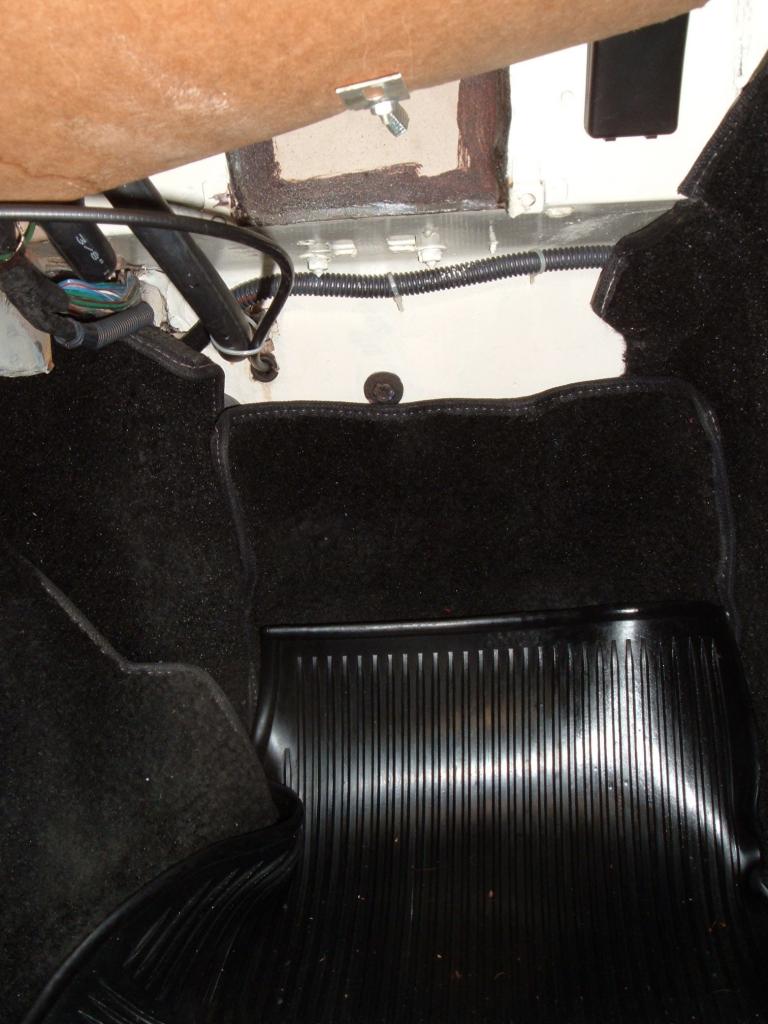

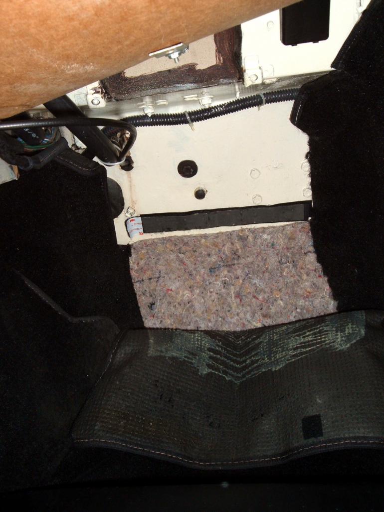

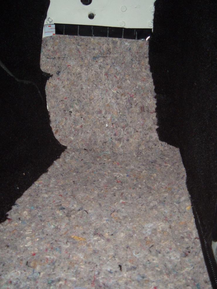

Bill:
The photo on the left shows the carpet in place. The photo on the right shows the carpet pulled back to show the Velcro strip that holds it, and you can see the heatshield (also held in place with Velcro). You can also see the remnants on the back of the carpet of the adhesive that once used to hold it in place. The previous owner didn't use any underlayer -- just carpet and rubber mat.
The Velcro adheres very well to the foil backing of the heatshield, but not so well to the back of the carpet because the back of the carpet is rubberized and heavily textured. For that reason, I had to stick the Velcro to the carpet using two-sided auto trim tape, and in some areas some liquid adhesive.
View attachment 25874View attachment 25875

Trying again... I hope these photos can be seen.
Randall: YES, indeed, the heatshield material looks a lot like the material for wrapping hot water heaters. And I agree with you about noise dampening. This stuff is primarily useful for cutting down on heat. But there is a little noise reduction, nevertheless.
Looking back on the project, I may have used more Velcro than really needed. Rather than continuous long strips, I might have simply used small squares stratigically placed. But either way, it seems to work.
