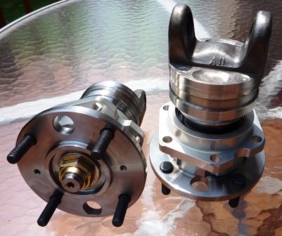

I just replaced both rear hubs with upgraded ones from Goodparts. They are much better than the originals and the price for the new ones was almost the same as rebuilding.
You might check it out.
