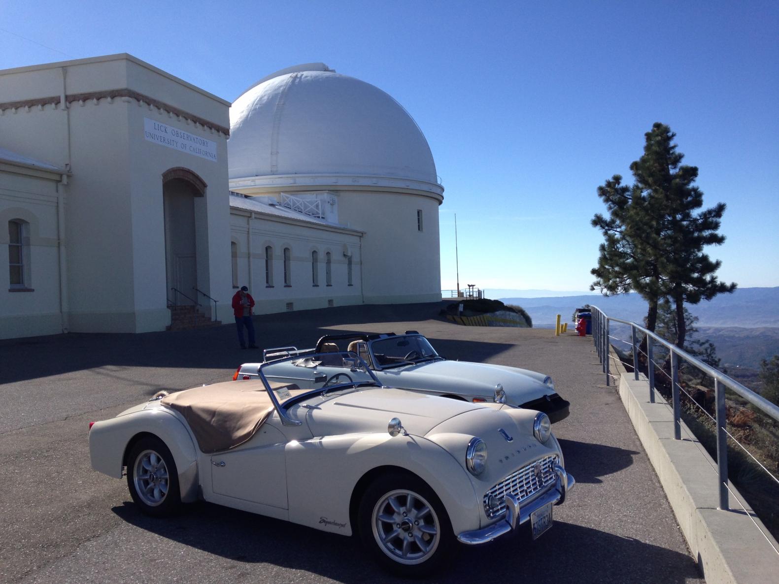

Well I just changed out my "coolant" for the "Evans" We are doing a drive up to Mt. Hamilton tomorrow. 4300' to the top up a winding road. We have done this drive many times. I will bring along 2 gallons of water and the old pressure cap "justin case" . I will post my findings later....

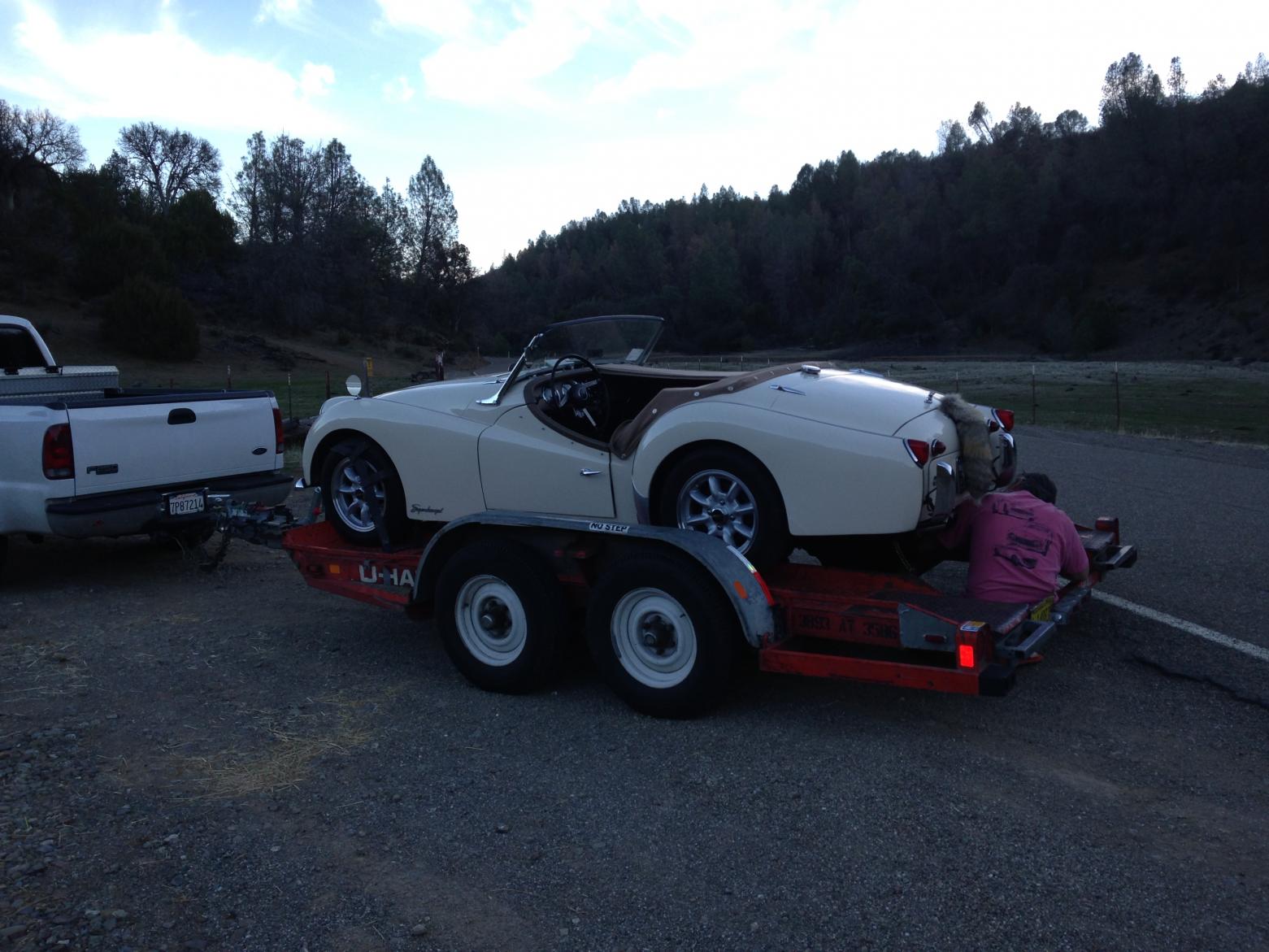

I used the waterless coolant on a drive up to MT. Hamilton. Everything was the same as on previous drives up the MT. Until we got down to about 20 miles from Livermore. The TR3 just died. No spark at the plugs. Had to be the coil. Drove 20 miles to town (in a MG) buy a coil then back 20 miles, Installed the new coil..... no spark. No cell phone coverage out in the sticks. So back into town (20 miles, in a MG:smile: ). Called a friend and met us in town, (25 miles from home) rented a trailer to haul the TR3 home. Back up the mountain 20 miles. Load the tr on the trailer. But there is nowhere to turn around so farther up the mountian to the junction of mines road and Del Puerto Canyon about 8 more miles farther up. We got back in to Brentwood at about 7:00 that night. Called Moss Motors and ordered new flame thrower electronics. I installed the new parts today and the TR fired right up. So if you use the Evans waterless coolant it can fry your petronics. LOL.......
