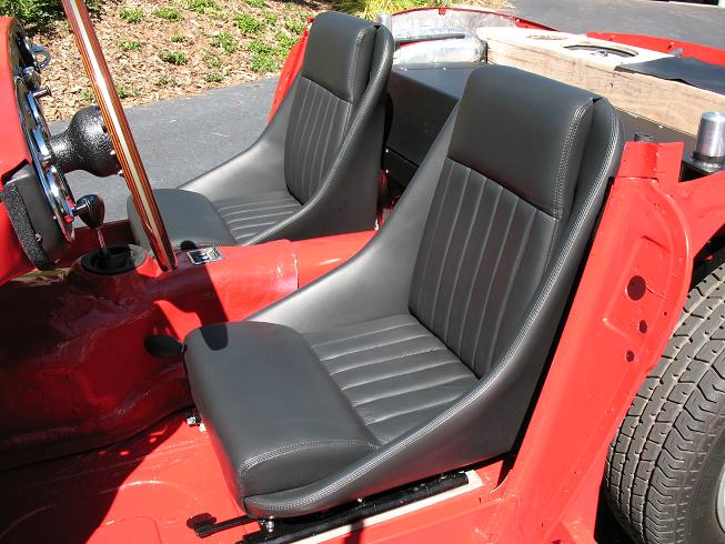

I had to scallop out the transmission tunnel on my BN7 to allow my Ridgard seats to move further forward.
You are going to love those seats I can tell you. There will be none of the trying to get out of the car after a trip and find it is difficult because your back is so sore.
I'll bet if your bladder could take it you could drive as long as you had fuel in the tank and still get out of the car and not feel a sore back.
One thing I did to my seats was to get the drivers side cushion recovered so it removed the piping from the right hand side. What happened for me was the weight of my leg on the piping would cause my right foot to go to sleep after a while (not a good thing). I had the piping re-routed so it followed the contour of the RH side panel. This meant new covering and new foam. The foam now wraps around the front to meet the sides.
It was easier to do than to explain it.

Bundyrum,
I see you correctly concluded that the extra space I built into my tunnel was for my Ridgard seats!...very good! And I appreciate your thoughts on the welting. I really liked the overall shape of the seats but decided to go with a more traditional Healey look on the upholstery and I took out the welting since that is also the most common wear point...and I added a Ricarro inflatable lumbar support (you can see the little black blow up ball in the picture)
I think I'll still have a problem going as long as I have fuel in my tank since I've got about an 17 gal. capacity...that's in my gas tank.

Hello HealeyPassion,
Great photo of the seats.
Mine sit a little different than yours because I raised the front 5 1/2".
Hope you shoulder works out for you.
