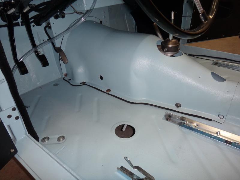

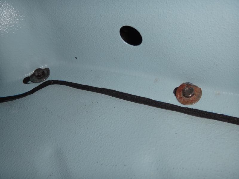

I was about to use the silicone sealer method that Randall and others have suggested when I remembered that I had several yards of black closed cell foam about 3/8" thick. I was going to use it for padding under the vinyl on all the interior panels that I rebuilt but decided that I like the appearance better with just the vinyl, no padding. I figured it wouldn't hurt to try cutting my own sealing strips from the foam and it worked out fine. I checked it to make sure that it was truly closed cell and it would not absorb any water. The gaps were larger in some sections so I was able to double it up. I've got a ton of the foam left over so if you want to try it I'll be glad to send you some, a freebie. It's certainly not doing any good collecting dust in my shop. Here's a couple of pics...

do you know how the material is going to stand up to heat and oil in combination? It may well be better than some of the rubber ones that looked like they melted over time.

Good point on the oil, I hadn't tested that. I did consider the effect of heat on the material though. I have a 1000w heat gun that I use for the application and maintenance of the covering on R/C models. I subjected a patch of the material to continuous heat for several minutes with no apparent adverse effects. I don't expect heat to be an issue in this case.
Regarding your point on the oil, I went ahead this afternoon and submerged a patch in motor oil. After about 3 hours it simply wiped away. None was absorbed, nor did the material seem to be effected in any way. I left it in the oil at the shop and will have another look tomorrow.

BTW, I left the sample in the oil for 24 hours and there were no ill effects. Also, the thickness is 1/8" rather than the 3/8 I quoted before. I'll send you plenty. It layers and compresses easily. Where I needed multiple layers I used contact cement to hold the layers together during installation. I did not cement it to the floor panel so the tunnel could be removed easily if necessary. One other point. I used the tunnel itself as a template for the curves rather than the floor pan.

Man your floor pans & tunnel are impressively clean!
FDA approved to use as a dinner plate.
RC64
Curious about the tunnel. It has a lot fewer bolt holes. Is it the fiberglass tunnel?
The tunnel is the original. Both floor pans had to be replaced so some of the mounting holes in the tunnel had to be "adjusted" a bit.
Rick...
CJD
Rick...
I would have sworn that you were missing a lot of bolt holes in your tunnel. I just went back and reviewed my pics, and you have just the right number. What's the first thing to go with age?? I forget...!
