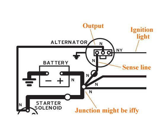

DNK
DNK
The one on the left I don't thin is a sense wire ,but I am far from a person in the know.
I'm the guy that's sits in the back of the class and throws out insults to the teacher.
The one on the right goes to the ignition
TR3driver
Great Pumpkin - R.I.P
NY would normally be the wire to the warning lamp on the dash.

DNK
As usual, I put my foot in it. It's the ign. light.
Good find R.

Sorry, Don, I misread the question. I believe Randy has it right, the leftmost connection to the alternator in the diagram above IS a sense wire. It's brown (N) because electrically, it is part of the same circuit, but it's function is to let the regulator 'see' closer to true battery voltage without being fooled by the voltage drop in the output wire.
And if that junction between the heavy battery cable and the smaller brown wires is anything like the one found on later TR6, then it's a common trouble spot.
Take it apart and clean things up (I've been experimenting with using Tarn-X to clean copper connections, so far it seems to work well), and make sure the quick connects fit snugly. Then if the problem persists, I'd try at least cleaning the alternator. I once had a similar problem that was caused by conductive dirt that had gotten inside the alternator housing and was upsetting the regulator.
After that, I'd say it's time for a new alternator.
TR3driver
Maybe this will help.

DNK said:
So the output wire is the sense wire?
I believe he labeled it "Sense line".
DNK
AHA,Duh
