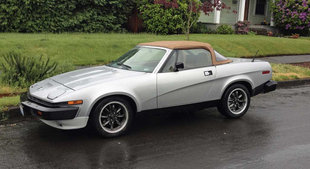

I just finished installing Rimmer's front rally spoiler on my TR8, and I'm quite pleased with the result. Still need to paint it, which I'll do in a couple of months when it stops raining here in the Pacific Northwet, but the gray gelcoat doesn't look too bad with my Argent Silver paint.

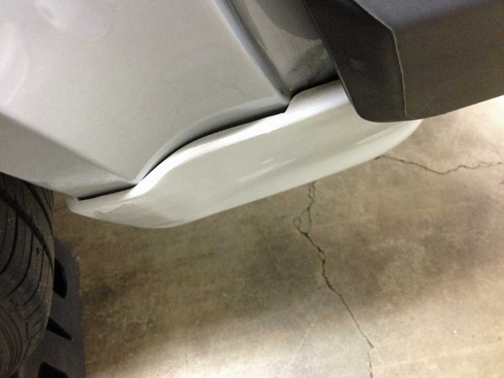

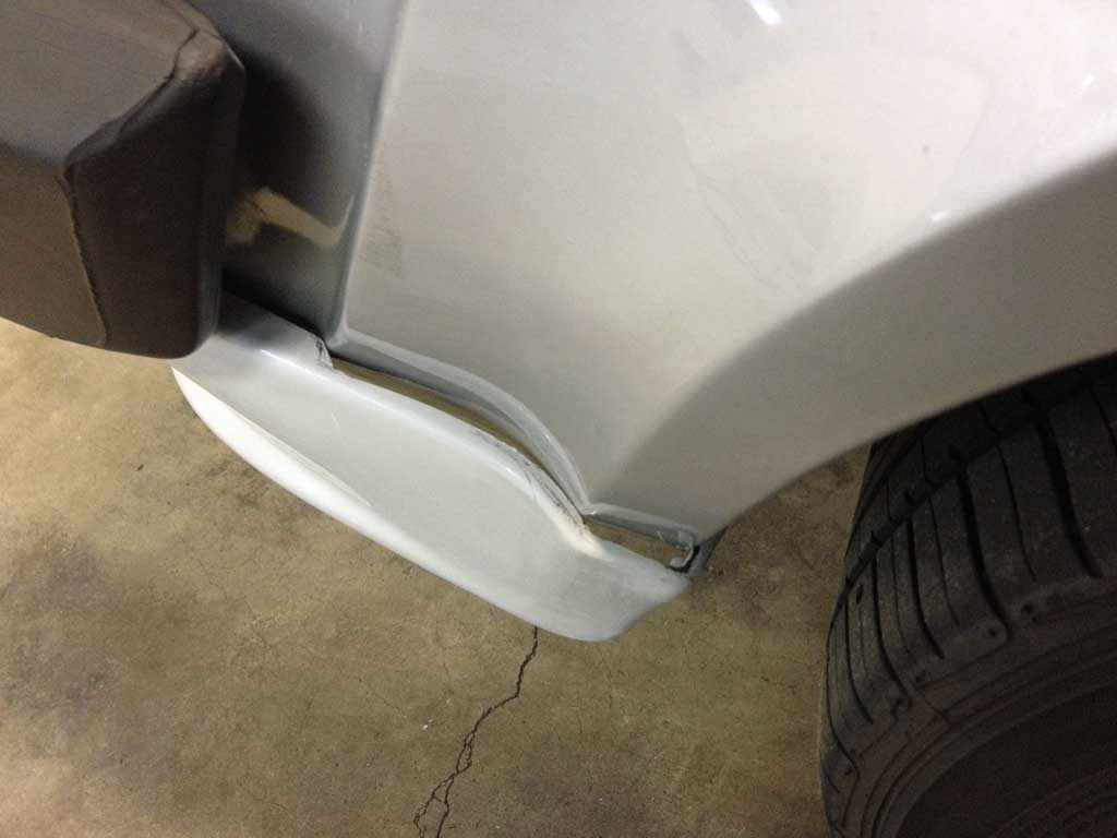

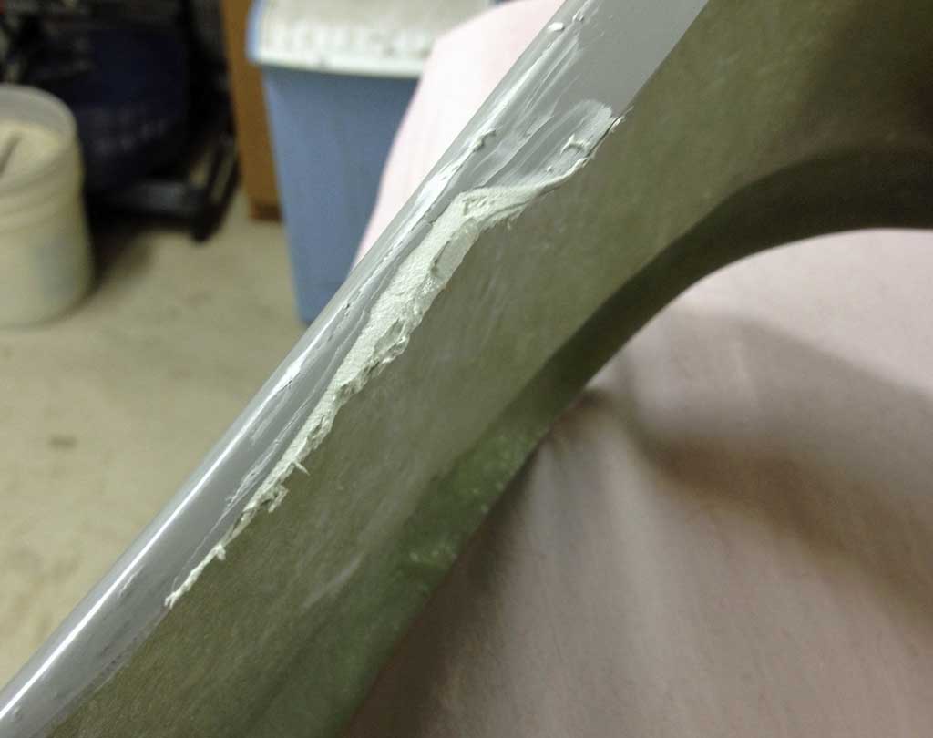

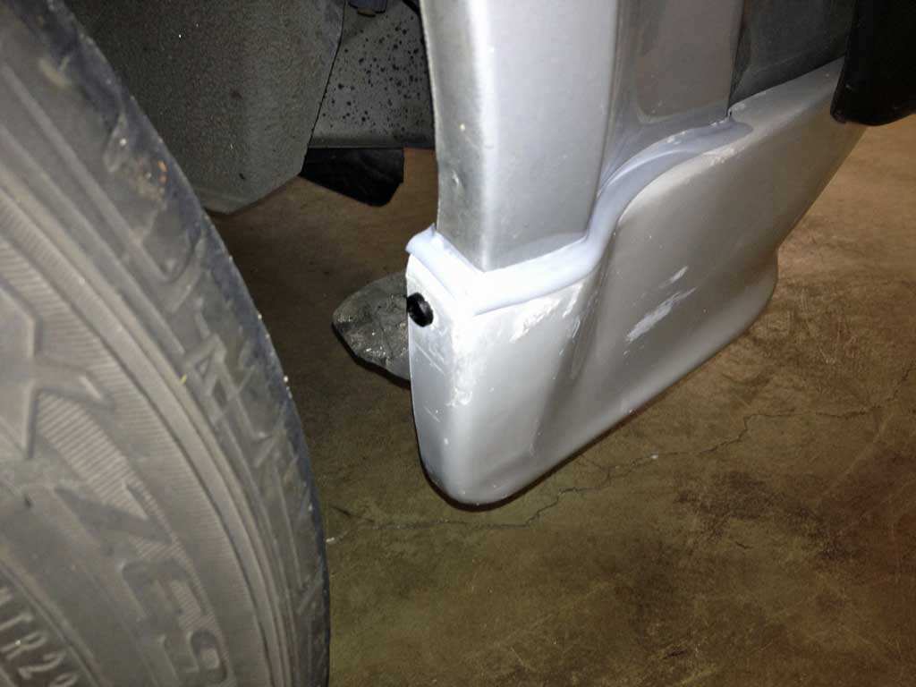

It took a bit of fettling to get it fit. The passenger side only took a bit of trimming (a coarse file cuts the fiberglass quickly), but the driver's side took a lot more work, both filing and filling. I used a paste-type epoxy to fill.

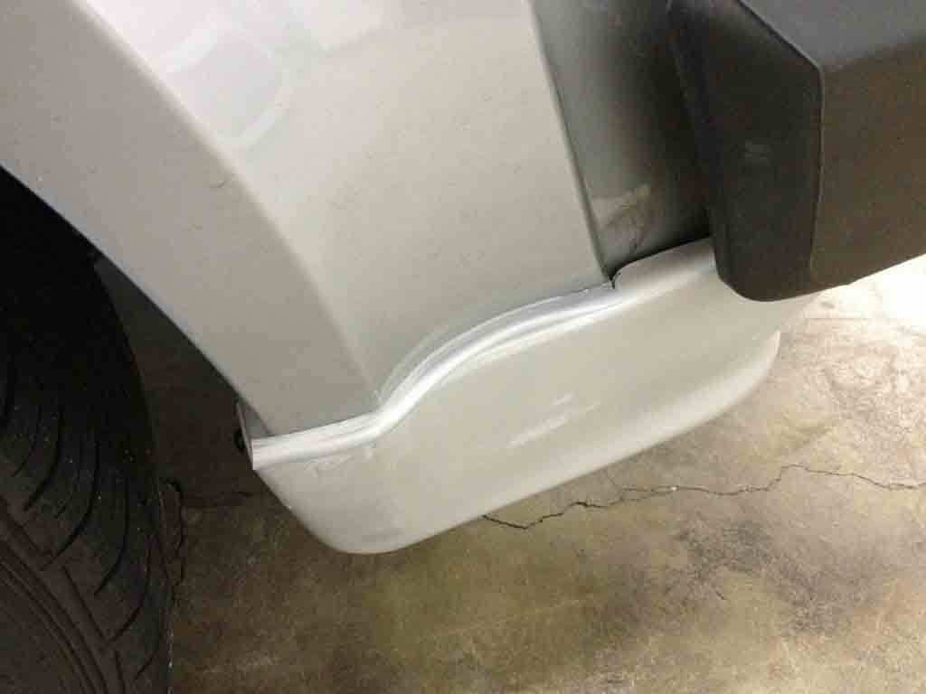

The stock spoiler attaches with three bolts along the front, and two on the ends that you reach from inside the front fender. The new spoiler had a place to attach to the one of the front holes, and tabs to connect at the stock locations inside the fender. I decided to use nylon hardware, my thinking is that if I were to hit something, perhaps the hardware would let go instead of shattering the fiberglass. I used a #10 screw on the center, and also added two holes inside the wheel well (the only two holes I had to make in the car for this). For the mounts inside the fenders, I used epoxy to attach two 1/4" flanged nuts to the fiberglass tabs, and nylon bolts with stainless steel fender washers.
I used some silver-gray welting intended for Trans Am wheel arches. I'm not 100% happy with that yet, there are some sharp bends that could be improved. I tried to overlap the welting, thinking that I couldn't make a nice miter, but I'll need to put some more effort into that. I used gel super glue to tack the welting to the spoiler while installing it.
I plan to paint it body color as some point. I considered black, thinking it might tie into the black lower body. But I found a picture of red TR7 with a similar spoiler in black, and it is just too much black up there.

... but the driver's side took a lot more work, both filing and filling. I used a paste-type epoxy to fill.
Is it to stiff to shave some on the back edge then pull it to the body with screws?
Darrell_Walker
Darrell_Walker
No, but on the driver's side, I shaved the entire lip off, and still needed filler. They just cut too much off.
I still need to sort the fog lights. The original brackets interfere with the spoiler (they are pretty large). I'm sure some angle iron will solve that. The lights may need to be a little more forward than before.

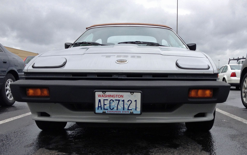

By the way
What good is the side shot of the car with it on
Get your knees wet and take a front on

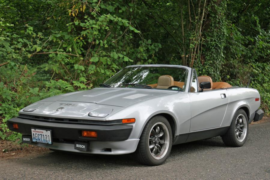

I got around to painting the spoiler, use a spray can from Automotive Touchup. Pretty good match, the new paint has a lot more metal flake in it, so it looks a bit lighter (the original paint is more like a gray with bits of metallic than what new cars have for silver). I also made up some new mounts for the fog lights, but I need to adjust them a bit as they are a little crooked. Probably were before, but didn't really stand out against the black spoiler.
