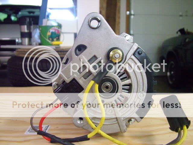

So it looks like on your connection info I used "S" and "L"
Why did I connect the "R" wire back to the case?

Don, you have the "S" (red wire into yellow) and "L" (brown wire) hooked up on that picture. You have the Sense wire hooked directly to the battery output, rather then down at the main junction. That will work if you don't have any resistance between the output terminal and the junction. Otherwise it will charge less then optimum.
What is this "R" wire you are talking about???

Two wires. One to the sens wire from the junction block I showed earlier. The second one from the dash light which feeds the ECU on my FI car.
I think the way you have yours wired, it will never detect any load and just run at minimum output. I think....
There should be a sense wire somewhere in your harness. At least it is on a stock TR8.
That's what the junction block picture was all about. Lower left is the sense wire feedback to the alternator.

Art, the "R" was suppose to be the red wire. I got the car with only 2 wires on the alt, though it had a Rover alt in it I think. I have no other wire there ,I plan on unwrapping it as soon as I talk to Clay about it.
Randy what is the wire you have in your hand in the pic above?
There is no "R" wire. I assume "R" means red.
If you look below you can see the letters molded into the black part of the housing. I rotated it to make it easier to see.
What you seem to be missing is a sense wire for the alternator.
From left to right = S F L P
I have no idea what that wire is for...hasn't broken yet :smile:

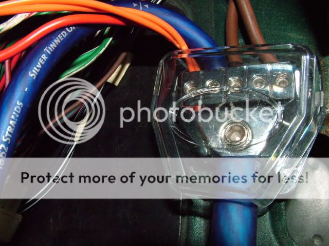

I have that small wire in the top pic and it is not connected to the battery wire terminal. Both the bottom lugs are being used for my FI fuse panel
Randy and all, Have finally nailed down my battery hook up and had it installed. Here is the battery wires hooked up with the + going to the breaker.
I got rid of the battery cable connection in the passenger side and used this instead.
