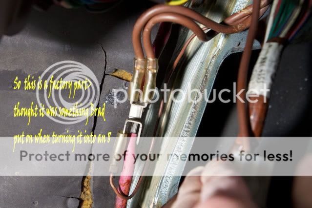

DNK said:Randy, Lots of questions and much to say about your pic.
Tomorrow as I have had way to much wine to type all of it
DNK said:Randy, how did you open the cover?
