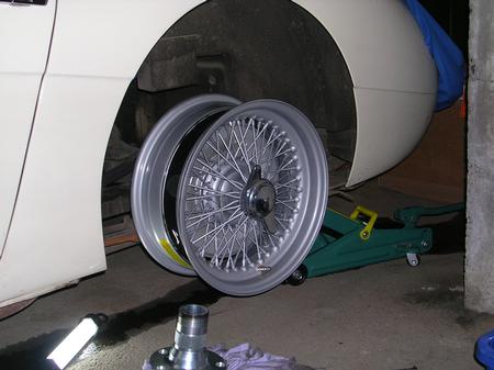

If your wire wheels are new with rubber which seal the holes to the spokes (look at attachment), you dont need innertubes. Else, you need innertubes. Is is smart to change them together with the tire. Be sure to remove any old rust and dirt on the inside of the wheels, and you should also have a rubber band between the wheel and the innertube to protect the innertube from the spoke nippels.
