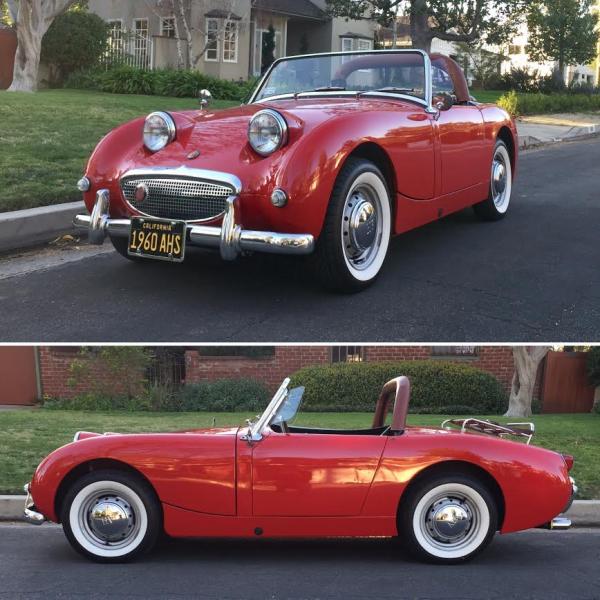

I recently got a set of Coker's BF Goodrich radial whitewalls in 155/80R13. I ordered them through Jegs, since they offer free shipping on orders over $95. They may not fit everybody's style, but I think they look pretty slick!
