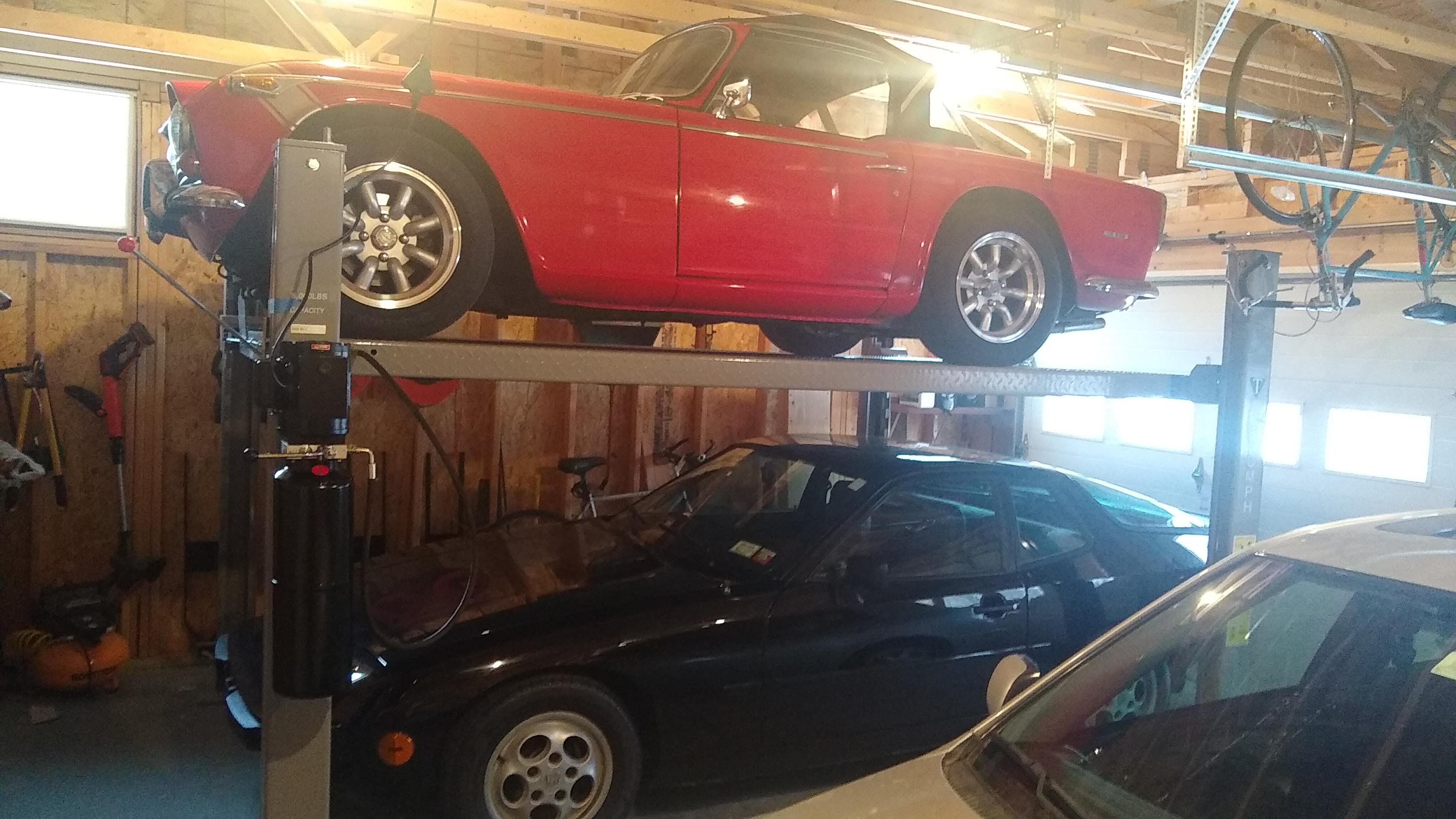

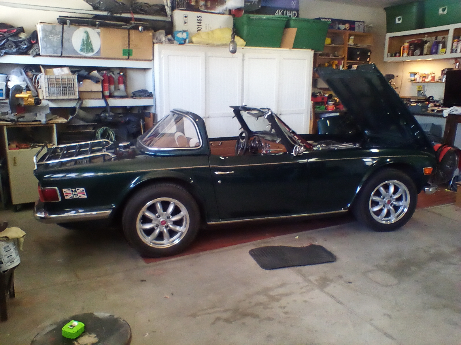

Two points Look at 18 Racing web page SCCA Cert, and not made in China. On my TR6 1973 I went to 16 inch rimes and tires many more options now days. I did have to add wheel spacer and new studs all from Summit Racing ( studs, spacers, and tires ) MF
Page 2 my wheels I fit TR logo in center also MF
