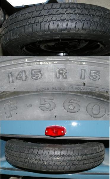

Edit: Oh, I went with the 165/80r15's all around, and the 145/80r15 for the spare. I'll report back later with the spare compartment fit...
