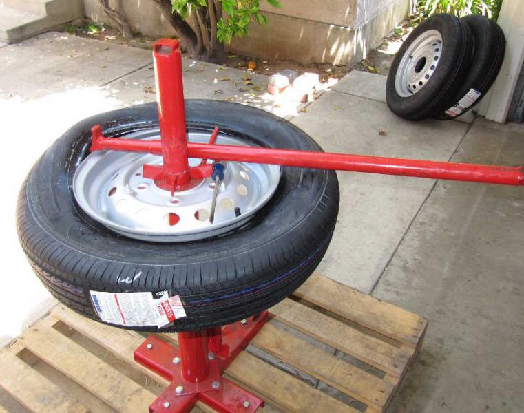

I am thinking of purchasing the Harbor Freight tire machine and balancer. Did you permanently attach the mounting machine to the floor? Or make it removable?
Geo Hahn
I have a lift and drilled 4 holes in one of the ramps where I mount the changer when it is needed. You want it well-anchored and it is good to have a lot of room to move around it.
Sarastro
You can mount the changer on a wood pallet. Then you can stand on the pallet as you use the changer and get all the leverage you need. It can be removed from the pallet for storage.
