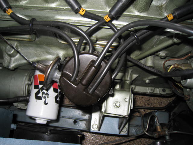

This topic comes up from time to time, here on the BCF. If you do a search you'll find many posts about it, including which spin on filter is best too. One of the highly recommended filters is the K&N 2009 filter. It incorporates the anti-drainback feature. There's more to a filter than just anti-drainback, and that was discussed in one of the posts. The write up was good, so I use that one now. It's canister is larger than most of the other filters, so there isn't as much wiggle room getting it in and out. Not a problem, just pointing that out.
