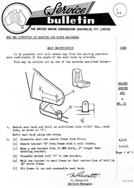

gfholl
Here are two other options. I went with option 2, had to replace the studs as well since they were to far gone.

I was going to ask for a photo of the new one thing, but, Gary, this is perfect. All I use for comfort is a lumbar support (which I really need to). Thanks.
