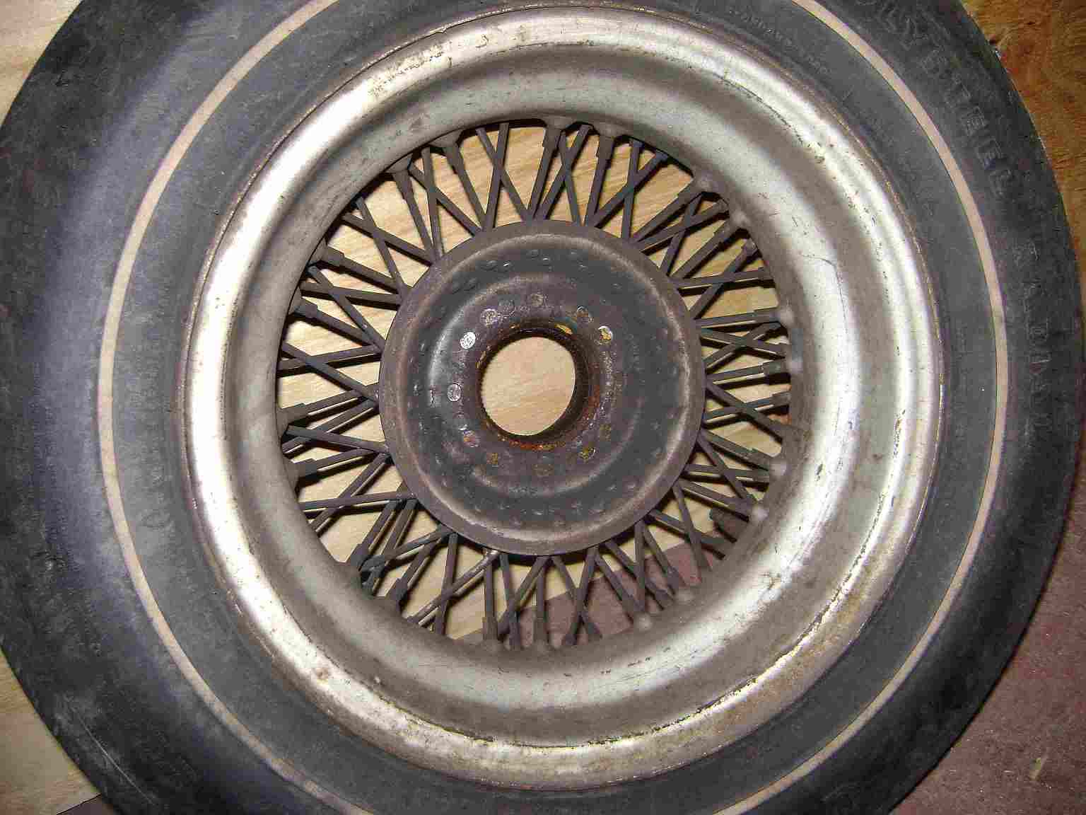

I had wires on my 73 Spit and I can tell you the stock lugs will hit the back of the wire wheel, (have the wheel to prove it).
I changed to alloy rims as I tore the splines out of the left front wheel. If it wasn't for the cost I would still have wires on the car.
Don R

Here is one of the rims. I actually have 2 that show damage.
I will try and get a better photo later. I noticed this when I had the wheels off doing some work. The ends of the studs on the left front were bent over dur to the pressure from the rims. (sorry no pics). I took a cutoff wheel and trimmed the studs back to the length of the conical nut and then had plenty of room.

Interesting...and puzzling! Is it possible that someone had changed studs at some point? Not that it should matter, but the center-lock wire wheels weren't used on Spitfires after 1969; starting in 1971 and for only a few years, Triumph offered Dunlop bolt-on wire wheels instead. Were your wire wheels used or new when installed on your car?
