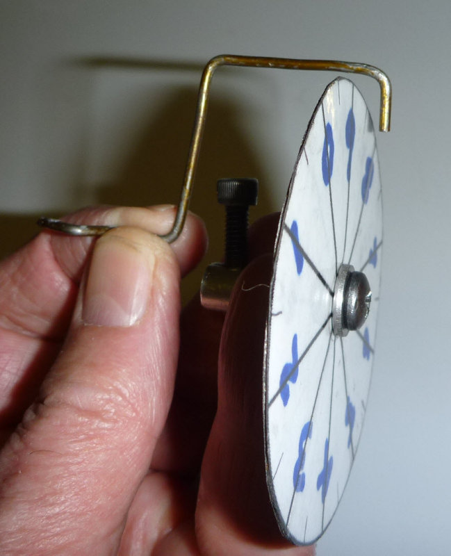

Made this speedo calibration tool which has been used on three cars to date:
John Turney
I give up--how does the calibration tool work?
The wheel goes on the end of the speedometer cable in place of the speedometer. The wire is a pointer. Roll the car forward 52.8 ft (1/100 mi. - 52'-9.5") and count the number of turns the speedometer cable makes. The pointer makes it easier to see the tenths of a turn. Multiply by 100 and that's the number of turns/mile.

richberman
Steve/John,
Why do you need to push the car, won't first gear do? And can you post how to build that tool?
steveg
The center hub is a piece of aluminum rod long enough to accommodate the square end of the cable and the screw holding the disc on. Half is tapped for that screw. A hole is drilled at right angles for the allen setscrew that holds the hub to the cable end. The disc is a piece of aluminum flashing. The circle is art downloaded from wiki images - circle divided into 10ths - glued to disc with spray adhesive. Number the gradations 0 - 9 counter-clockwise (disc rotates clockwise). The pointer is made from coat hanger wire.
Remove the speedo, tape the pointer to the cable housing with duct tape. Loosen the disc screw and adjust position of disc at zero.
Not shown - I used a piece of coat hanger wire taped to the front bumper as a pointer to the ground and pieces of masking tape on the pavement marked at 52'-9.5".
Nisonger says it's important to push the car by hand through this distance - some issue with the diff, I forget. Do it 3 times and average the results. IMHO this is a 2-person job so you may have to recruit a "Dreaded Assistant".

It's hard to move the car exactly 52.8' by driving, and because of gear slop, you can't back up and be accurate. Yes, do 3 times and average.
