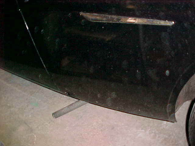

there he goes kuttin bits and pieces again!you must have the lightest healey in the world,now i know why all those concourse judges walk around twitching!dont let him get hold of a plazma cutter! /ubbthreads/images/graemlins/grin.gifi found a piece of rubber hose that fit the bleader very tighly,safety wired it on and cut it so it hangs dowm about 3" below the frame and left it there,just have to turn the bleader etc. /ubbthreads/images/graemlins/yesnod.gif

$$$$$$$$$$$$$$$$ Anthony and you still gotta pump,plus ain't it enough trouble to get off now!!----Keoke- /ubbthreads/images/graemlins/yesnod.gif /ubbthreads/images/graemlins/laugh.gif
keoke,that aint the real hose!and im never going to remove the one i put on,plus my son has good strong legs to pump for me,its a good way to get him interested in the hobby,spend some time,like that! /ubbthreads/images/graemlins/yesnod.gif
